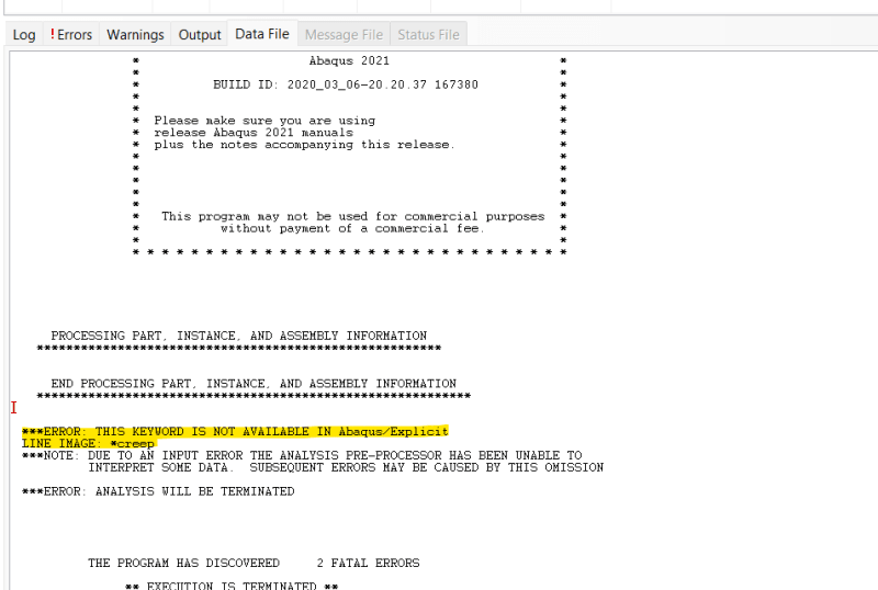

Hi, I have created a model with repeated loading defined in tabular amplitude. I have used dynamic explicit step for this purpose. When I submit the job, I have come across an error " THIS KEYWORD IS NOT AVAIALABLE IN Abaqus/Explicit", Any inputs on this would be great.
What keyword ? The error message should indicate it. Check the log files for more info.

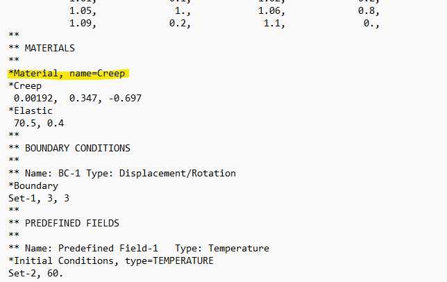

As highlighted in the data file, it shows creep is missing.But in the inp file I could see the creep details.Is there something I am missing
First image is the data file, second image is the part of inp file
The problem is not that this keyword is missing but that it's there in an analysis not supporting it. *CREEP is only available in Abaqus/Standard, not in Abaqus/Explicit.
