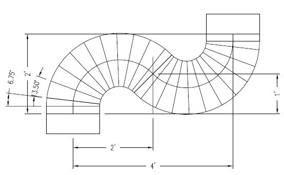

I have an upcoming project that requires an offset in some 16 inch pipe but don't have room for two 90° elbows. I believe this can be achieved using rectangular ducting but there are complications of very high vibration and rapid temperature cycling of up to 1000°F within minutes. What type of engineer specializes in this type of design? This one is way over my head. I don't know where to look.

Center to center is 48 inches.
Moving the bellows into the horizontal run is an option it would gain 14 inches of additional vertical clearance vertically. I can possibly swap positions of the SCR and muffler to get the SCR further from the engine to make room in the horizontal run for the bellows.
3D, I intended to use turning vanes. CFD would need to be performed which is not in my wheelhouse which is why I'm interested in hiring a consultant.

86 inH2O is my allowable back pressure

It is only 1 psi, make it out of 10 ga or even 7 ga 309ss maybe 11 gores for each of two 135 degree elbows. A good industrial sheet metal shop can knock that out. This sketch has a 14" c.l. radius.

DVD you have just described a $100k welding job...
... don't forget to add material costs and overhead!
I would certainly like to do it for less. To buy the correct outlets for the engines is $60k so if I can rig together a solution for half I am off to a good start. The correct outlets are not available to purchase within our required timeframe.
