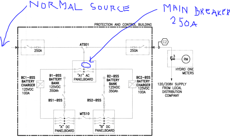

Protection and control building is supplied via 75kVA (208/120V) service via source A (station service transformer stepped from 230 kV line to 208V, 3ph). At few instances, source A dropped and automatic transfer switch (ATS) switches to source B (208V/120V supply by local utility). ATS output feeds AC distribution panelboard which has main 250A breaker. When this condition occurs, main breaker trips. The temporary meter was installed to capture the waveform and there is significant inrush current that appears to be seen by the breaker which causes the trip (around ~1200A). See image below. Any help is appreciated.

Also, It was confirm temporary meter was placed on lugs of ATS leading towards the main breaker that tripped (See SLD attached).
So all of the currents and voltages were measuring only current and voltage on the load lug of the ATS. With a 15 second transfer time, then the switch was still connected to the normal source. There should be no effect of out of phase transfer because the transfer has not occurred. Seems like the strange voltages are caused by the normal source. What kind of transformer is it? 230 kV - 208 V is unusual. What actually tripped?

- The issue appears to be on 230kV side; 75kVA transformer is stepped down from 230kV line. Once 230kV breaker trips (due to intentional, planned trip), there is a charge from 230kV underground cable (about 7km long) between two stations; one of the path to the ground is through this unit which causes a surge on the system on 230 kV HV side, reflecting it to LV (208V) side.

Is this feature activated?The ATCO 300 appears to be a very fast transfer switch. No neutral delay is possible.
Suggestion. If the 230 kV is disconnected at the source, we may be seeing capacitive discharge raising the voltages.
If the cable is ringing it will ring at a frequency dependent on the combined capacitance and induction of the cable.
That would explain the subsequent peak several cycles after the initial event.
Now the puzzle is: What components in the loads will suffer severe current transients with a phase shift in applied voltage.
