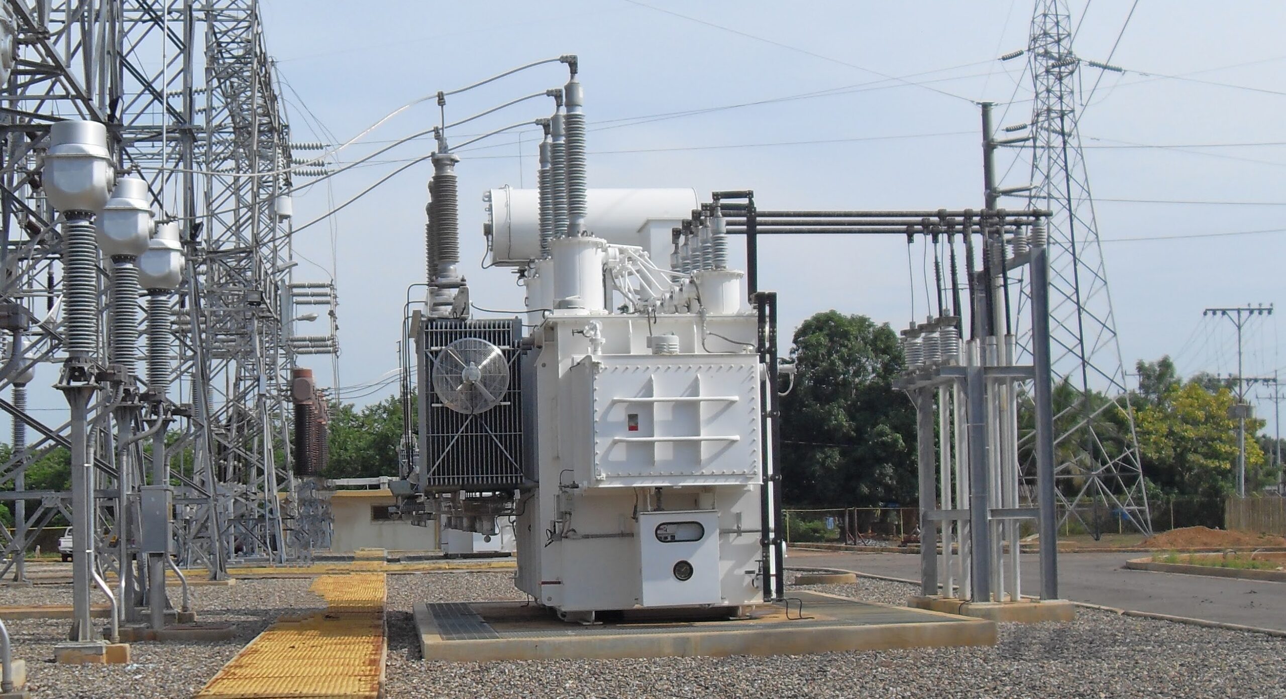

Hi All,
I was just curious if anyone has any better or contradictory information on transformer inrush probability than this excerpt I found (out of a PhD thesis by Jinsheng Peng, "Assessment of Transformer Energisation; Transients and Their Impacts on Power Systems", Pg. 174):
"Furthermore, it was found that the probability of reaching the worst case dip magnitude (estimated by the commonly agreed worst case energisation condition) is lower than 0.5%, indicating that the worst case scenario is unlikely to occur in a system; in fact, about 80% of the dips are likely to be with magnitudes lower than 0.6 pu of the worst case."
I'm on a project involving an islanded power system. We have a couple of transformers that will be powered by either one or two generators. The transformers are fairly large relative to the size of generators so we are planning on some inrush testing before start-up.
The purpose of our testing is not to find the 0.5% worst case condition. If the above probabilities and my math is right, we'd have to energize one of these transformers 138 times to have a 50/50 chance of seeing that 0.5% level of inrush. However, if testing one of them 10 times has a really good chance of seeing the 0.7-0.9 pu type of inrush, that's what we really want to see. We want to measure voltage dip magnitude and duration during this testing and imagine some sort of distribution as indicated by the 5 x 4 grid of 20 inrush curves, Figure 6, about 2/3 down the page of this link:
Thanks for any and all help!

What is your concern with inrush current? If it is strictly voltage dip, then you have to define your acceptable criteria. The transformer manufacturer should be able to give you a reasonable estimate of maximum inrush current. Then you have to decide if this is acceptable. The probability distribution will depend on so many factors, I'm not sure benefit you will get from theoretical discussions. Also, the load being picked up on energization will impact the time constant and maximum current. I'd probably focus on being able to deal with the worst case inrush and sleep better at night, as waross says.
The typical inrush curves for transformers assume an infinite bus approximation. For an islanded system with a transformer larger than the generator, that will be a rather poor assumption.
I am rather confused that the links suggest that 0.5% probability means something will never occur. If there is 0.5% chance to blow transformer fuses, and blow fuses then means you have to spend days without power while waiting for transformer testing equipment to arrive from the mainland, that may not be an acceptable consequence. However if the consequences of are less impactful (e.g. just redo the generator starting sequence) then aiming for a different acceptable probability may make sense for your situation.
First, I really appreciate the replies, and from some very knowledgeable posters that I've learned from just reading threads I'm not even in. FWIW, we have no fuses involved and the transformers will always be unloaded during transformer inrush. Yes, I don't discount the 0.5% probability case as never occurring. However, the transformers only see inrush during startup so during a less critical time. Agreeing with others here, it's the repetitive nature over time that worries me more. It's also with it happening to a crew that is not electrically-inclined than with engineers on hand.
So, the unknown for me is sort of wrapped up in this whitepaper from Cummins. I just have no idea what to expect based on this.
https://www.stamford-avk.com/sites/stamfordavk/files/AGN070_B.pdf
It starts right off by indicating 1X transformer inrush off a genset (+/- 25%), not 6X, 8X or 12X. That's why I am not even mentioning measuring current levels. The inrush current no longer seems like anything that would complicate a coordination curve as we usually tackle. I don't see how to link a grid-tied inrush multiple to a voltage dip range. I have some old GE databook curves that estimate voltage dip percentage but they are for a large motor line-starting on a generator. How much faith should I put in this Cummins whitepaper where it suggests the inrush would only be in the range from 0.75X to 1.25X?
My plan of attack was to lead a certain number of repeated closures of the transformer breakers. I wanted a pretty good chance of hitting the 60-100% of worst-case range of maximum inrush. If I can believe the 80%/0.6pu number, then 10 repeated tests would have an almost 90% chance of seeing something in that range, 14 tests about 95% and 20 tests almost 99%. I am thinking then that 20 would be the number of tests spaced with a few minutes between each closure and split up evenly between the two identical transformers.
The manufacturer of the generator breakers unfortunately only offers a broad range for where the voltage drop-out will trip them, somewhere from 40-65%. However, for other controls powering off this, I'd say if testing shows voltage dropping down to 80-85%, that would certainly be worrisome. A drop to 70-80% would probably all but require addition of premag circuits. I don't feel we need to see some 0.5% probability 50-60% voltage drop, for example. If we hit that 70-80% at any point in the testing, then the test is concluded at that point. I'm not sure I see the advantage in the above link's use of "excitation-build-up" vs premag.
