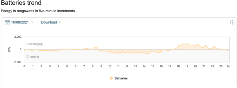

How has the prospect of battery storage changed any of these estimates? The report cited by FacEngrPE was 10 years old. A lot has happened in 10 years with respect to both battery technology and entrepreneurs investing in batteries, both in their production and their availability as part the power grid infrastructure.
Here is California, the organization that manages the grid, California ISO (Independent System Operator) has a website where you can track the status of the state's power grid including the contribution of various power sources as well as the current usage. I occasionally visit their site if for no other reason than to see how much are renewables contributing to the grid versus more traditional and conventional power generating technologies. Recently I noticed that they're starting to include 'Batteries' as one of the sources, or at least including it as part of the available statistics. Granted, the contribution is minuscule, at the moment, but I suspect that that will change in time. Of course, batteries are not a true 'source' of power, but since the site is showing the current contribution to the current status of the grid, it can be a source at any one moment. Below is a graph of what yesterdays charge/discharge curve looked like:
You can clearly see that the batteries are charging during the day and discharging in the evening. From the profile (and this is consistent with other days that I've looked at), it would seem that these batteries are being used to balance a solar farm since the numbers match almost exactly the periods of sunshine and darkness. Now, based on checking the values, which you can do from the screen using your cursor, it appears that the maximum discharge rate is just under 1,000 MW's, not a lot compared to other 'sources', but certainly something that can help. I suspect that over time, these numbers will go up as I think the state operators are adding batteries as part of their improvement project.
For anyone interested, here's the link the California ISO site:
To see the status of different 'sources', select the 'Supply' option from the list in the middle of the page.

I just read a press release (link below) from the California ISO where they've recently increased the grid's battery capacity to 1,500 MW with plans to add an additional 1,500 MW by the end of the year.

Without reading it, I'm confident it doesn't contain an energy unit.
Now why would a press release about energy storage not contain any energy units?
Well, the graphs still shows that approximately 1,000 MW of capacity is still online, so I guess if you subtract the 300 MW from the reported 1,500 MW...

John, 1500 MW is a rate not a capacity. The sparkies will be more interested in figures for Mega-Watt-Hours than in a Mega-Watt discharge rate for an unknown time period.
