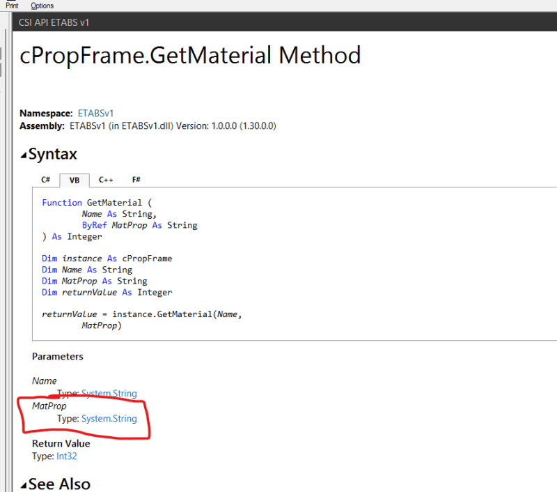

Hi, I cannot select frames and walls based on section properties in etabs v21 and then delete selected frames and walls. Can anyone suggest to me the code to do it using Excel VBA code?

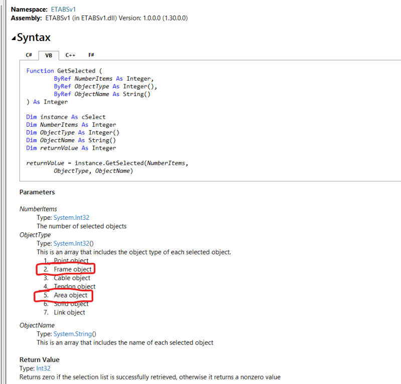

Rajavardhan, I would think a combination of getting selected objects, filtering out frames and areas and then testing for material property types would do the trick.
S&T
I have tried it, but nothing happen
ret = SapModel.GetSelected(NumberItems, 2, 0 - Delete - Beam)
Can you please write those few lines only to select and delete it
Hi Raj,
I have not coded in VBA before, but the code in C Sharp needs to look a bit different than what you have shown.
C#:
int NumberItems = 0;
int[] ObjectType = null;
string[] ObjectName = null;
_SapModel.SelectObj.GetSelected(ref NumberItems, ref ObjectType, ref ObjectName);
