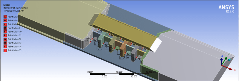

To apply the below water modeling approach in ansys WB (mechanical) I have used remote attached point masses to model (M0) and a 1 m^3 solid box ( I had added it to the model in design modeler) connected to the structure with 2 longitudinal springs as shown in the images below.
Note: I have divided M0 into to point masses and attached one point mass to the left wall and the other to the right wall.

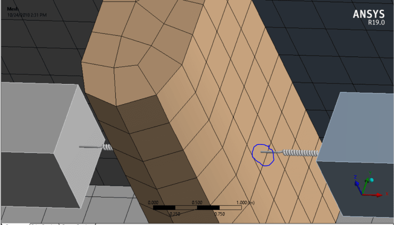

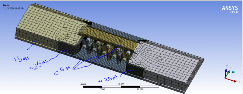

About the second error: Post a few pictures of the mesh. Too coarse mesh can cause this.
Edit: Post a few pictures of the mesh/springs/point masses.

The mesh size of the structure is 0.5 m *0.5 m except the 2 walls of the regulator where the element size is 0.25 m *0.25 m

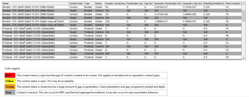

You could add a contact tool under Connections and check the status of all the contacts before solving. Some of the contacts might be sharing the same surfaces on either contact or target size and this leads to the error.
This is what I have found in the initial information of the contact tool. I tried to change the formulation and regenerate the initial information results, but I got the same table. there is another ansys file for the same model but without the mass points and longitudinal springs- block system which have the same contact tool initial information table and it was solved without errors!! do you have any inspirations?!!
I'm wandering also why there is no any information about the longitudinal springs or mass points which are attached to the structure surfaces under connections??
You can add status plot to the contact tool by right clicking it to visualize the contacts.
Contact tool only includes information about contacts.
"At least one contact pair or remote load has no elements in it."
If you look through the "Number contacting" column of the table, can you spot a faulty
contact with 0? As you can see the number is reported only for contact side, not target.

the model by activating them one by one. Are those boxes between walls solid? Why are they not meshed?
What is the spring attaching to if there is no mesh?
Yes the boxes are solids, but they are rigid so they are not meshed.
