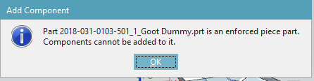

Oct 31, 2018 #1 Lars1978 Mechanical Joined Dec 30, 2015 Messages 327 Location NL What does this mean? And how can I change it ? Lars NX12.0.2.9 native Solid Edge ST10 Inventor
Oct 31, 2018 #2 matnas Mechanical Joined May 10, 2011 Messages 52 Location SE https://community.plm.automation.siemens.com/t5/NX-Design-Forum/Enforced-Part-What-is-it/td-p/419541 /Mattias NX5 -> NX12 I-deas 12, NX I-deas6.6 Solid Works 2017 Upvote 0 Downvote

Nov 1, 2018 #3 Toost Mechanical Joined Jan 18, 2011 Messages 3,009 Location SE If you have clumsy colleagues,... You can hinder them from adding components to a part which shouldn't have components. / Tomas Upvote 0 Downvote
