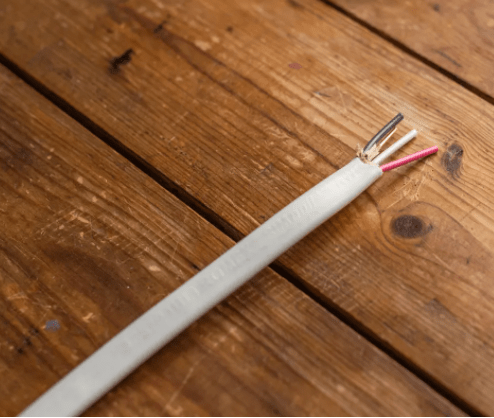

I was looking at this product on Lowes web site:
From the info given, I have no clue as to the wall thickness or the material grade used (as the specs mean nothing to me). Lowes (of course) couldn't help. Can anyone tell me the info I need from this? Thanks.
EDIT: To save you a look....it says (as far as specs go):
Type EMT
UNSPSC 39131700
Have no clue what that means.
Well I did find a picture not sure this is right, but they look like our old telefon cables. :-)
If this is the one they would not be allowed for anything here, maybe low voltage 12VDC for LED lights.
/A

In the USA you cannot use conduit in houses for the general wiring.
You use metallic conduit in commercial settings as being more protected and more adaptable to future modifications.
The Romex you use in residential you protect from nails by using these plates if the wire is closer than 1-1/4" from the wall covering:
Keith Cress
kcress -
Romex, or once called Loomex has withstood the test of time.
That sample may look like telephone wire but the conducyors are solid, #14 AWG and rated for 15 Amps.
