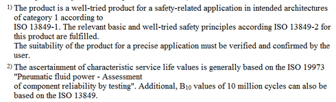

There might be standards for pneumatic valves that shows the requirements are fulfilled.
Like these for instance.

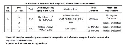

Is this just much ado about something? Does the component actually fail IP65 testing? Are the seals failing?
Yes. It has failed testing.
I think the question is - did it fail to function?
Then there is nothing anyone here can help you with. You have a problem with your customer that needs to be addressed to the customer.

So if the valve "Worked perfectly before and after the test" then it passed, didn't it.
If the valve is working fine before and after the test, technically it hasn’t failed in functionality. But from a standards perspective, it didn’t meet IP65 and water ingress was detected, which disqualifies it per the spec, even if the ingress didn’t affect operation.
The customer seems to be strictly going by documentation and standard compliance, which is fair in some industries (especially rail).
If redesign isn't an option, you might just need to look at external sealing or housing options like NEMA enclosures. Otherwise, you’ll probably be stuck in this loop where the part performs fine but still gets rejected.
Did they give any room to discuss alternative compliance routes, or are they hard set on the literal IP65 rating?
