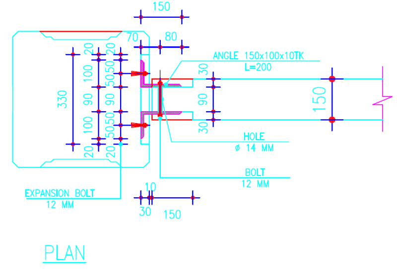

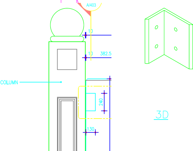

Dear All,
This is regarding the concrete column to concrete wall panel connections that to be established by L-angle (weld). For the same structure that're discussed in this tread require this connection. Both column and wall panel are precast members. I would require to check whether this connection shown in this attached Fig. is adequate or not.

Akshikas,
It is better to open a new thread, this thread is too long for people to browse. Unless you need to reference back to the calculation.
Dear retired13,
Posted as new thread Link. Thank you.
