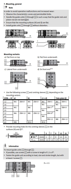

I have a welded frame with 4 Festo air slides to lift a product. It's worked fine for months but now seems to bind and jamb more and more. I've had maintenance do all the usual suspects - oiling, check air line, etc.
I'm assuming because it's a weldment that the cylinders are just fighting each other due to misalignment so my solution is to replace the bolts with shoulder bolts that will give the cylinders a chance to move a little and hopefully solve any binding issues.
Is there something basic I'm missing?

OP,
Instead of going back and forth about the merits of rigid mounting, see below from Festo. For the way you are mounting the actuator you need a flat rigid surface, which you do not have. If you know of an alignment issue, then fixing that would be a good idea but I wouldn't make things worse by making the actuator looser in hopes of self-alignment.
