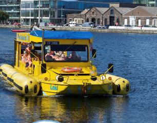

The current DUKWs they run in Dublin also seem to have inflatable sponsons.
