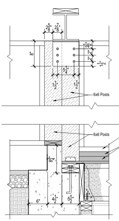

THE SITUATION
- One story post.
- Somewhat important support for steel beam.
- Field issue has arrived and this is what arch wants.
- Prefab wall panels. I expect that they'll accomplish the level bearing to begin with.
MY CONCERN
I'm a tad concerned that sole plate shrinkage on the right will be more than on the left and that the beam bearing will seem some differential settlement as a result. Then, maybe, the beam will rotate and cause drywall cracking issues etc. On the other hand, I wouldn't expect the differential bearing settlement to be more than 1/8".
Am I worrying about nothing here? It will come as a surprise to no one that I occasionally struggle to remain "solution focused".
