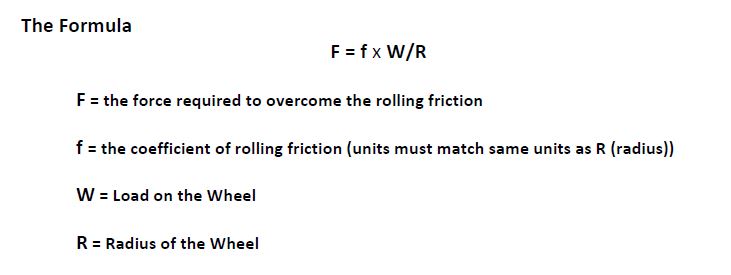

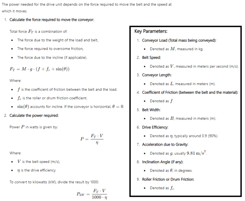

It is a kevlar belt with multiple rollers between the head and tail pulley. So, would it be accurate to update the formula as shown below?
Belt Pull = Wm + Wb + force applied * coefficient of roller friction
rolling friction coefficient has units, see below
