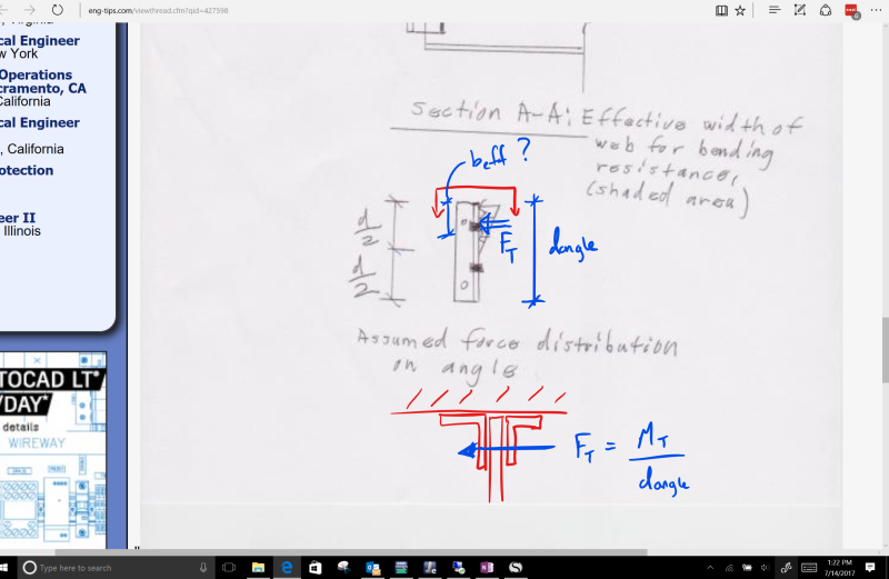

In my case the beam web is pretty thick (>1"). But the angles are not (5/16"). Any suggestions on the effective width of the angle?
Thanks again.
EIT

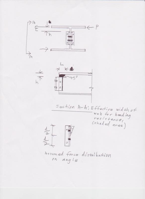

Assuming you are talking about the force distribution (from the force perpendicular to the angles)......I typically assume a triangular distributed load. (See pic below.)
By the way, if you run with this, keep in mind (for the "stick" model): the end torsional fixity isn't going to be 100% fixed or free. Estimating that is important to determine rotation. In the study I mentioned in my first post, I typically got conservative (i.e. higher than theoretical) rotations by releasing just 10% of the fixity. However, that probably will vary from beam to beam based on web stiffness.
By the way, in my pic, I don't show a cope.....if you've got one....you've got issues trying to get this out of the beam.

Regarding the angle -
I was talking about the force perpendicular to the web applied to the outstanding leg of the angle. I was thinking about checking the outstanding leg in bending. I was only thinking about using an effective width equal to the length of the out standing leg.
To go with your mark-up....I'd take "beff" to be "d/2" (my notation; i.e. half the angle depth of one angle).....with the load distributed as I show it.
