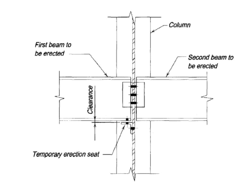

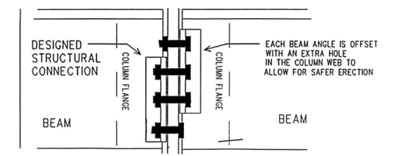

We use "shear end plates" in the US sometimes. Just not very often compared to angles or shear tabs because of some fabrication and erection issues. If the beam is cut a little too long, that's no big deal with angles or shear tabs. With end plates, the beam needs to be cut a little short and then finger shims might be needed. I try to get around this by using angles or a shear tab on the other end of the beam.
Is that what you guys do with these?
