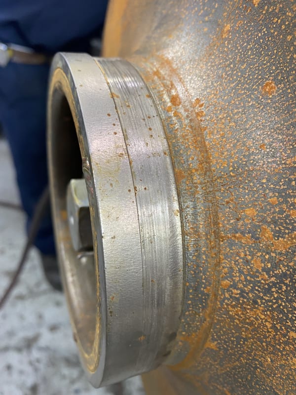

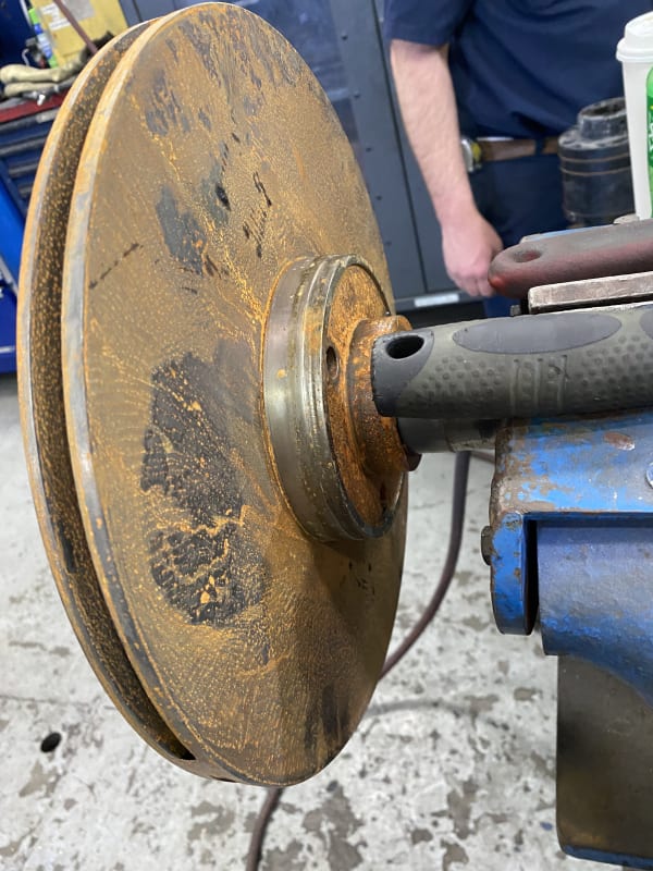

We have a vertical inline pump here that failed probably because of rotor unbalance.
Based on impeller sizes (Impeller OD:13.75” and width 0.5”), D/ B=27.5 since it is greater than 6, it should be static balance (which we did during previous repair about a year ago).
The pump rotor lost its center position during operation and rubbed to throat bushing and wear rings (please see attached pictures). Would you suggest dynamic balance even if D/B is greater than 6?

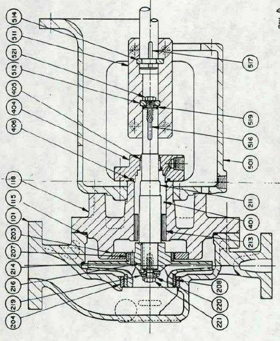

Pump assembly drawing.
Dear Engineers,
Do you have any suggestions on the root cause of this issue?
Here is what I think about it. Looking at pump assembly drawing, the heavy rub on throat bushing (item 213) (smallest clearance area) and eventually the rub on wear rings can be caused by one of the following.
-There was hydraulic imbalance meaning that the pump was ran too off from BEP, where hydraulic forces on impeller were not balanced and made the rotor move, hitting the throat bushing.
-Impeller was not balanced and was jumping around hitting the throat bushing ID.
-Any thing else?
That style of coupling is prone to causing poor shaft run-out. I have seen these assembled with one of the keys turned the wrong way, causing very high shaft run-out. On some of these, there is not enough room above the mechanical seal to take a good shaft run-out measurement with everything assembled. For that case, I would assemble the shaft, coupling and impeller, hanging vertically in the shop. I would verify that the run-out on the lower impeller wear ring was acceptable before putting the assembly into the pump case.

I'm assuming piece 213 is the throat bushing.
That means there are no bearings on the pump side of that coupling. I'm not familiar with that kind of construction. It looks like a long distance to the closest bearing (the closest bearing isn't even shown on the drawing). I'd think that would make the impeller very susceptible to side movement due to that flexibility of that long unsupported shaft. The coupling might perhaps contribute to that shaft flexibility even though its' supposed to be rigid. At least that's what comes to my mind being a non-pump guy. I'm a little curious if this is a common construction or if the wear rings are supposed to "act like" bearings (I know I've heard they do in multistage pumps).

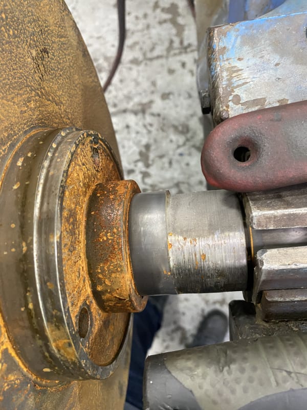

The rub on the shaft at location of piece 213 throat bushing looks like it's only one one arc of the shaft. Maybe that suggests something like a transient.
(2B)+(2B)' ?
You are correct, Pete. This is a rigidly coupled vertical in-line pump. The pump has no true bearing. The nearest bearing is the lower bearing in the motor. Deep wear on one side of a shaft suggests a bent shaft. Improper assembly of that rigid coupling causes the shaft to be kicked off to one side, creating the same effect as a bent shaft. This does not look like a failure caused by imbalance. The coupling is the most likely source of the problem.

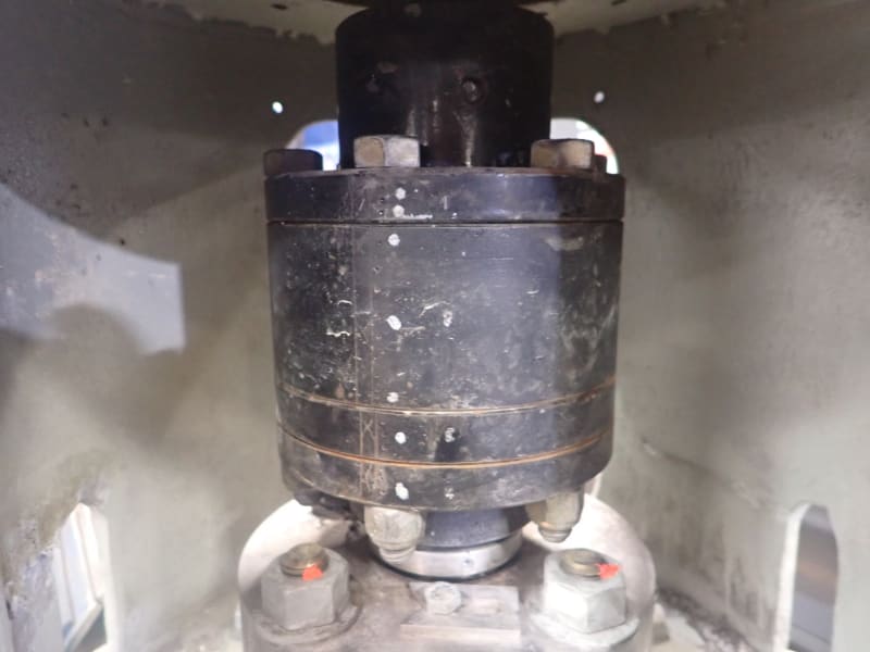

Here is the type of coupling the pump has (showing pump coupling hub and motor coupling hub separately). I still stand with my original comment that the root cause is probably imbalance because the impeller was 1-plane balanced (per API 610) not dynamic balanced.
No. It does not have a clam shell coupling. But, the coupling in the picture is still a rigid coupling, just a different type. I do not believe that a pure couple unbalance resulting from a single plane balance would cause the damage you have shown. I still think it is a shaft run-out problem and probably resulting from problems with the rigid coupling.
In some ways, the coupling in the picture is worse than the one in the drawing. At least the clam shell coupling can be tightened to an interference fit on both shafts. The coupling in the picture requires a slip fit on the motor shaft in order to be able to assembly the hub over the split ring.
Johnny Pellin
Your theory about hydraulic imbalance does not work either. If the shaft was pushed off to one side because of running too far from BEP in single volute pump, the damage to the bushing would be on one side, but the shaft would be grooved all the way around. Deep damage on one side of the shaft and all the way around the bushing is a classic indication of shaft run-out (bent shaft).

I have never seen that style of coupling used in a vertical in-line pump. That coupling is common in big vertical turbine pumps where the shaft is under considerable tension. I don't believe that coupling is a good choice or appropriate for a vertical in-line pump. It does not provide enough radial stiffness since both hubs are a loose fit on their shafts. If the pump were to experience up-thrust from high suction pressure or from running beyond end of curve, that coupling would let the shaft buckle off to the side, resulting in the sort of damage you show.

Just so I understand correctly, the coupling shown above is flexible coupling not rigid coupling because it does not have shims (spring type allowing it to be flexible) in between the motor and pump hubs correct?
The shaft run-outs were measured (on V-blocks) during previous repair about a year ago and they were within 0.001" (as API 610 suggests).
This coupling shown has 0.001"-0.002" interference fit against motor shaft (will be heated up to install) and has 0.001"-0.002" clearance (loose fit) against pump shaft.
I missed to mention the case on this pump has two opposite cut waters (volute lips). Doesnt that make the flow more balanced during operation? I will re-check if the damage on shaft is all around or just one area.

Unless I am missing something, that is a rigid coupling, not flexible. It does not have any disk packs, rubber elements, diaphragms or other flexible components. If the motor hub is an interference fit, that is better than a loose fit. Normally, those are a slip fit. I am not sure how you remove that hub. I guess you heat it up, slip it on too far, install the split ring in the groove in the motor shaft and then pull the hub down over the split ring before it cools. In order to remove it, you have to drive it up, press it up or heat it quickly so you can slide it up to get the split ring back out. Strange.

The pictures above clearly show that the damage is much deeper on one side of the shaft and one side of the impeller wear rings.
