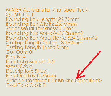

Does anyone know how to edit the treatment/finish in the cutting list for sheet matel?
E-stone
Oct 28, 2020
21
This image is from the drawing.
This image is from the model.
I could change it in the drawing manually, but I cannot change it in the model. I wonder whether there is a way to change this property in the model, so that I don't need to change it in the drawing manually.

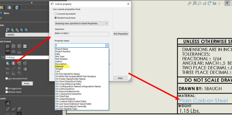

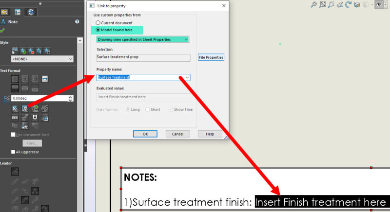

To have properties from a part or an assembly show up in a drawing automatically you have to have the text linked to the property. See the image below:
Properties from the part into the drawing:

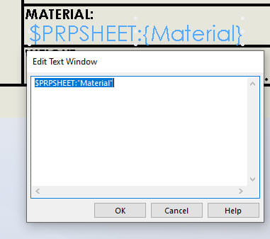

Two ways to do this Manually type it in by RMB the text and selecting "Edit text in Window".

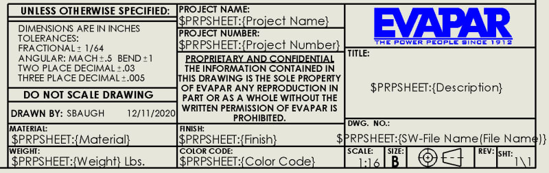

The 2nd way is to place a CAD model that has all the properties you want to show up in your drawing into a new drawing template. Select the text and use the Link to property, select "model found here" then go to the drop-down and select the property.
Once you have all the text properties set you must save your sheet format as a file and your Template as a file. copy and paste the text to or copy the template file to a new name and reset your template options (sheet size etc...)

Thank you for trying to help. I know I could type whatever I want once the field is unlocked. However, this way does not change anything in the finish or treatment. I mean I would like to change the estimated value - Finish <not specific>.

Thank you for your efforts. I know how to link a property as you showed. When the property is linked, the content is linked with the model. However, I would like to change or specify the finish, like we can change the material in the model and the drawing will automatically update the property.

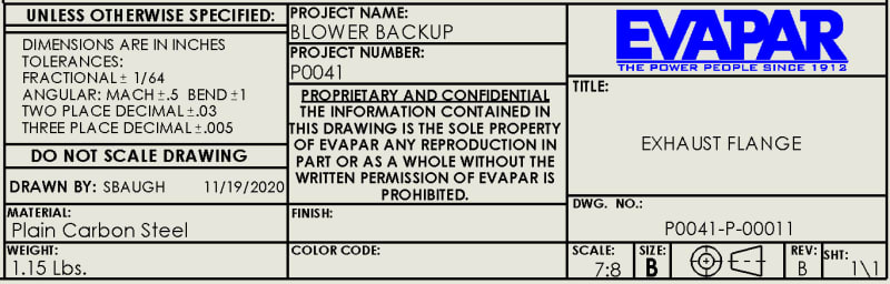

Hello Scott,
I have attached a photo, like this one.
I wonder whether there is a way to change the "Not specified" automatically. Just like we could change the material in the model, then the drawing could be updated automatically.
Thanks,
E-stone

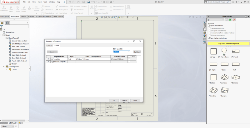

Hello Scott,
I couldn't see the picture properly, but I guess this is what I meant. I could not find something that looks like what you have in the part or drawing. Do you mind telling me where you found it?
I tried file>properties. However, the maximum information I could get is:
Thanks,
E-stone

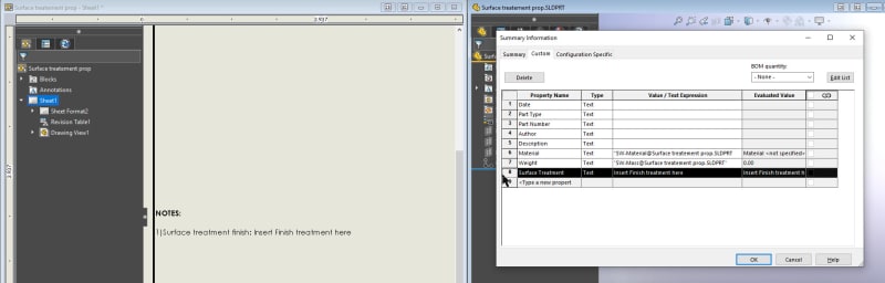

Weird, I thought we used to be able to click on the image and it would expand so it could be seen... anyway

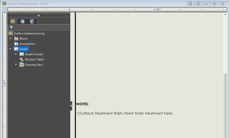

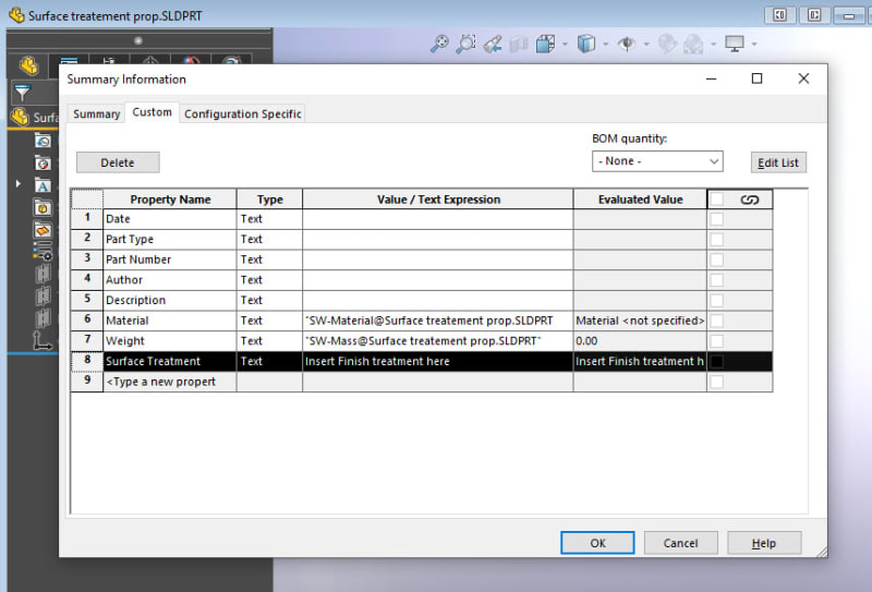

I made a "property" in the part called Surface treatment. I gave it value. In the drawing, I placed the part into the drawing and created a note, and linked it to that part property.
Within the drawing:
Forever that note is going to be linked to ANY model specified in that drawing with that property.
You can now remove the part and save it as a template\sheet format. Then whenever you have a part that has that "Surface treatment" property in it the drawing will auto-update every time.
It's no different than what I originally posted I just used your property. You cannot change a part property within a drawing. You can only change where it's linked and change the item that controls the property, it's not bidirectional and I am glad it's not.
