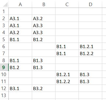

i have a journal to get distance between two components by name or select, and a list of many pairs of components in excel table

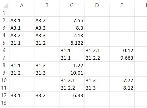

how to get name of those pairs of components from excel table to NX and put the distance back into the excel table

excel table:
result:
