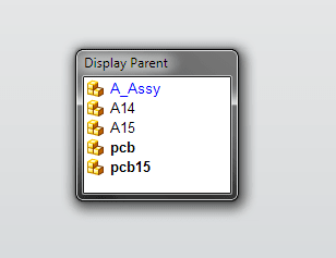

I've just stumbled on this tool mady by CNSZU. Originaly posted on thread561-351100. Seems like a usefull thing for me unfortunatelly I can not load the library. I also found switch part tool which, in the 1.4 version, works great for me and basically could do the same job + more. But its rather slow to load whole assembly tree everytime if i would like to diplay just the parent part (which i hope is much faster to process).
Is there any chance you (CNSZU) could provide at least decompiled journal of the Display parent tool which might work or maybe then I could debug on which line the problem is.
Or if enyone else know better way to quickly diplay parent part.
Any help would be appreciated.
I'm using NX 9 with Win7
Thanks MyKL

Yeah, I've noticed his last login. And I've also tried the journal you mentioned with no success. No error just nothing unfortunatelly.
Mykl
Thank you for your time. It's definitelly quicker in terms of loading and might be even faster if not loading all opened components. It's not showing every parent though, only the top level one.
MyKL
I have removed preview of model, so the code now works faster. Do You still want to display only a parent of open (work) file?
With best regards
Michael
Ideally all parents of work part, no need for diplaying other parts. Just like in the preview from CNSZU.
