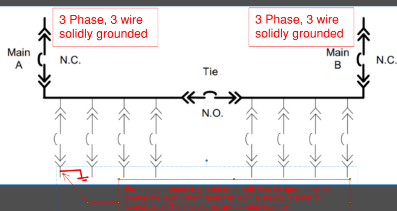

Hi All,
When a single phase to ground fault occurs with a Bus tie open, where does the fault current go?
As always, it depends. Where are the two sources located? If they are both local transformers, the current will all flow to the Main A transformer neutral through the ground grid. If the sources are from the same remote substation, some of the return current will flow through the earth to the remote substation, some will flow through each of the shield wire/neutral to the remote substation. If the sources are different remote substations, some current will flow through the earth to remote substation A, some will flow through the Main A shield/neutral to remote substation A, some will flow through the Main B shield/neutral to remote substation B, then through the Substation B ground grid and earth to remote substation A, some will flow through tower grounds of Main B and then to the remote substation A ground grid.

If there is no metallic connection between the enclosure and the source, then ground fault protection may be compromised because the fault current will be low. You could use sensitive earth fault protection, but I would assume that the enclosure ground is tied to a ground grid that is also connected to the transformer or generator neutral either directly or indirectly through a transmission line shield wire of cable shield. I'm guessing that the 3-wire solidly grounded means that there is no neutral taken to the switchgear, but that there is a ground conductor.
Dear Mr. NickParker (Electrical)(OP)22 Nov 22 15:52
[COLOR=]"...When a single phase to ground fault occurs with a Bus tie open, where does the fault current go?..."[/color]
1. It is possible to have 3-phse 3-wire with Neutral solidly earthed (but NOT distributed) generator/transformer with Y winding. The gen/trafo A and B may be close by or distance apart; with same or different earthing pits.
1.1 Attention: (a) the Neutral point of A and B shall be separated.
(b) a single EF CT shall be located as close as possible to the Neutral point
(c) the whole length of the earthing conductor shall be insulated.
2. In case of an EF occurs on Section A, irrespective whether the earthing wires are connected in two earthing pits or solidly connected together, only the EF CT located at the gen/trafo A will detect it. The EF CT in gen/trafo B will NOT detect it.
2.1 Attention: The earth-fault current may flow all over through conductive structure/ earth etc. etc.; but ultimately flow back to the gen/trafo A only. The EF current will NOT flow through EF CT B to the gen/trafo Neutral B.
Che Kuan Yau (Singapore)
Fault current will use all provided ground paths to return to its source, the A Trafo, assuming it's secondary is wye and the neutral is grounded.
