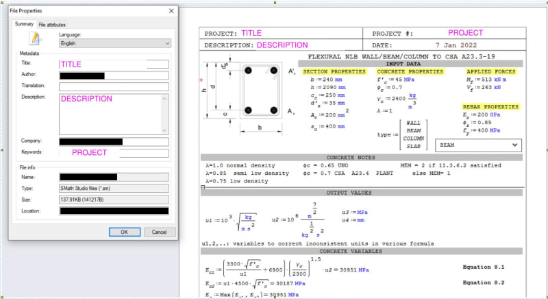

Wow, I'm glad to see the increased usage of SMath. I used to use a "background image" for a template, but you may want to look into using a header. This will avoid some of the scaling issues you might be having.
Basically, I have a template file that I start every calculation with. I try to take screen captures of software output and put them into SMath. For example, I might define the loading on a beam in SMath on one page and put that info into a steel beam program (say RAMSbeam), then screenshot that result into SMath. I'm using SMath as you would use OneNote. If I need to draw a free body diagram, I would draw it in Whiteboard (or OneNote) and then screenshot it and paste it into SMath. I haven't thought about printing smath and then putting it into OneNote for additional annotation, but I suppose you could.

In SMath we use a background image with fields in the header so each page automatically lists the calc info.
@Brad805 - Nice Work!! Honestly yours looks better than mine.
I do that often... you can use the Windows snapshot to directly paste into SMath. I often do that off page, so it doesn't print. I also do a lot of cut and paste from other programs.
