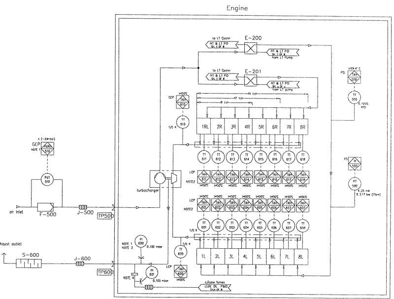

I don't think thermistors are correct, they're probably type K thermocouples in the exhaust ports, maybe type J. Look at the wire color if you can. If you run the engine at a constant load for a while you can use a multimeter to probe each thermocouple. It doesn't really matter what the reading is but you see a lot of deviation that would indicate problems with individual cylinders as opposed to turbocharger/intercooler problems that would affect the entire engine.

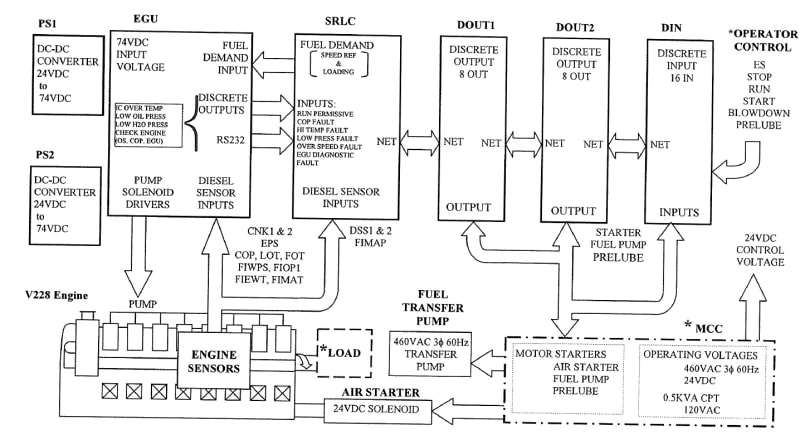

Here are our air system P&ID drawing and hardware block diagram for reference.

Turboateng, yes You are right, it is thermocouples, not thermistors. I just wrongly named it. K type.

Here is Word Doc of your configuration,
(for some reason the insert link for attachments was not working for me today)
If you look at Service Menu J, Limiters (page 8), you see you have no access to settings .04 (Torque Limit) and .05 (Smoke Limit) because your firmware has an "Opacity Map" with three selections, these were mapped fuel rate to MAP limit maps developed by GE to limit exhaust smoke per IMO and some other regulatory guidelines, you can't change them you only select one of the three, with the 20% map being the "cleanest" and the 30% map allowing more fuel for a given MAP. If you change the parameters from 1 to 3 you may see a slight difference in the engines performance.
On same page is the Analog Input scaling, the scaling is set for 4mA=0PSIA and 20mA=75PSIA, because the MAP sensor is critical to the proper operation of the limiter map, you should verify for proper operation, when check its calibration make sure you do a 5 point check and check linearity and hysteresis, since the standard sensors used by GE and Woodward over time could have issues with both.
As we discussed before, this is a custom control with a lot going on inside of it, one of the ports is configured RS232 for communicating to the engine ECM and the I/O modules, the other port is configured for Modbus, not sure if you're using it but it will have a ton of info on it if you are inclined to use it.

The two parameters you are asking about are for your governing dynamics, not your fuel limiter mapping.
No you don't have to do a 5 point verification on the MAP sensor, but it will be a guess as to if it is working the way it should. Why not do it right and know for sure the MAP sensor is doing what it is supposed too? In the firmware configuration your MAP sensor is very important.
In doing performance testing with the 723's and engines using either multi point fuel limit maps, opacity maps or air/fuel ratio maps that a supposedly "good" MAP sensor would cause all kinds of grief. So as a habit whenever I deal with one a do a pretty complete check of them, and in some cases get rid of the cheaper automotive type sensor and go to a more robust (and adjustable) industrial type sensor. This may or may not be part of the problem, but should be an easy box to check off and know for sure.
