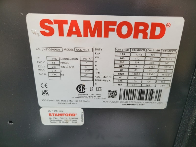

I was wondering if somebody could help clarify the power ratings for a diesel generator for me. A vendor is trying to sell me this generator (I think it is all he has in stock...) and I am convinced that it is larger than what I require. I require a 80 kW prime generator to service a variable load that typically varies between 35 kW minimum and 76 kW maximum. The vendor provided me with the attached datasheet and tells me that this is a 90 kW prime generator and would be suitable for me. As far as I can tell this is a 114 kW prime generator with a parasitic load of 2.8 kW giving a net prime power of 111.2 kW. Am I missing something? Is there a reason why the vendor is telling me that this is a 90 kW generator? I'm concerned he is trying to sell me a generator that is too large simply because it is all he has in stock.
I am confused as to why the datasheet includes the following:
Generator available power @ Prime power kW 80 100
Generator available power @ Stand by kW 89 110
I don't understand the difference between the "Generator Available Power @ Prime Power" and the "Prime power (net)". Are they not the same thing?
I appreciate any advice.
Gino
Generators are not 100% efficient, so the difference between 80 kW and 89.4 are the losses in the genny, 10%, not bad. You can get better if you spend more money no doubt.

Thanks for the responses. I believe the genset has a 110 kW, prime rated, Stamford End as per the following:
Surely, given the variable nature of the load and the fact that on average the load is between 35 kW - 40 kW with brief spikes up to 76 kW it would be more fuel efficient to have a smaller engine running at a higher load factor?

The two columns are for different frequency - What's your frequency?
Prime power looks to me like shaft output power from the engine - you need generator power which is typically 10-15% below engine shaft power. Use of the word "Prime" can be confusing.
