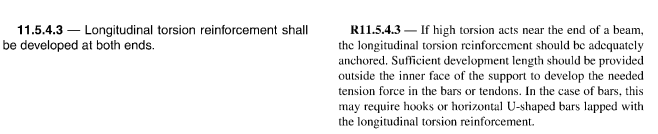

I am currently detailing continuous beams to the ACI codes.
Previous answers to questions I have asked on this forum have been enormously helpful.
I am trying to find justification to terminate the side steel stiffeners short of the columns; due to limited space within. However I cannot find any justification for this in the codes. I have found that shear links(stirrups) can be stopped 50mm from the columns but
nothing yet for stiffeners.
Please advise.

The bars I am referring to are not main structural tension /compression members,which are continued into the column; for
obvious reasons. The 'stiffeners are 12mm bars whích have been specified in the side of the beam to improve torsional resistance.
If continued into the column they will clash with the column steel. I would like to terminate them just short of the column.
I am looking for a reason in the ACI codes to justify this but I have not been able to find any.

Torsion in beams is usually greatest at the ends - the additional longitudinal bars added for torsion (ACI calls them Al) are mostly required at the ends and do need to extend through the support.

While the longitudinal torsion steel doesn't need to extend through the column, it is my belief that it needs to extend into the column some distance. We usually conceive of concrete beam torsion as a three dimensional network of diagonal compression struts. Those struts need to be anchored over the support by reinforcement in a manner similar to the struts that we envision at the supports for simple shear.

@OP: If congestion is an issue, I think that one could terminate the longitudinal torsion bars at the faces of the columns and then splice them together with a designated splice bar that passes through the columns. Maybe some nice, generous, non-contact lap splices.

Distributed reinforcement along side faces (skin reinforcement) should develop beyond the point at which the bar is stressed. There is no specific requirement for continuing skin reinforcement, so the basic rule would apply. This would require development beyond the last stirrup (link.) You may discontinue these bars once developed, but avoid lapping inside the columns unless there is a lot of space. Avoid splices, heads, and hooks inside columns as these make construction more difficult (or impractical.) This reinforcement is principally to reduce width and extension of diagonal ("shear") cracks. (The mechanism is the same as for vertical stirrups, that is restraint of splitting tensile cracking inside compression struts, aka shear cracks.)
