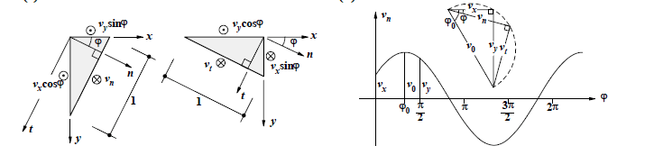

I'm working through a design for a partially underground concrete tank. The structure is modelled using plate elements in STAAD. I am having difficulty rationalizing the proper way to transform the plate element forces (Sx, Sy, Sxy, Mx, My, Mxy, SQx, SQy) into proper design forces. My problem is that my mesh is non-orthogonal. If the mesh were orthogonal, I understand that I could use Wood-Armor theory to design the reinforcement in the orthogonal axes (Mx + Mxy and My + Mxy). Additionally, if the mesh were orthogonal, my SQx and SQy would line up with the "typical" section cuts that would be appropriate for checking one-way shear.
However, as stated, I have a non-orthogonal grid due to some openings and irregular pile layouts. My current approach for flexural design is to determine the principal membrane stresses (S1, S2) and the principal moments (M1, M2, M12) using Mohr's circle and take the design moment as M1 + M12 or M2 + M12 and design for the interaction of that moment with the membrane forces. I am relatively comfortable that this will produce a very conservative design for my flexural reinforcement and, honestly, is more than most people would likely do. However, this hinges on the idea that the moments can be transformed similarly to in-plane stress. Does anyone have a resource that might confirm this?
Second, is the issue of the transverse shears (SQx and SQy) on the non-orthogonal mesh. I have looked everywhere for a resource that might help explain how to get a "design shear value" however, most, if not all, resources assume a regular grid. My inclination is to assume that SQx and SQy are always "principal" forces, regardless of the orientation of the plate local axes. When I do so, I get reasonable results, but I just can't justify the reasoning. Does anyone have any thoughts on this approach?

This approach will be too conservative in some cases .If Mx ≥–|Mxy| and My ≤|Mxy| your approach could be acceptable.
The following snap from (Practitioners’ guide to finite element modelling of reinforced concrete structures ; FIB Bulletin 45);
Vn= Vx COS φ + Vy SIN φ and Vt= - Vx SINφ + Vy COS φ
