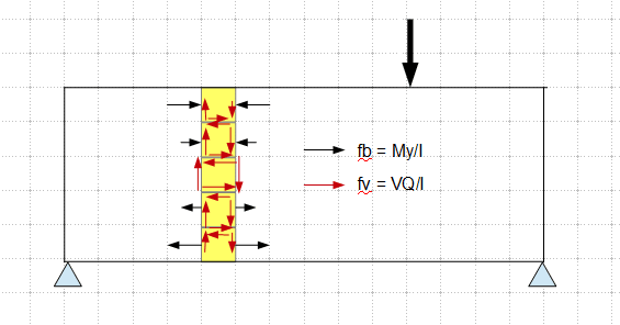

STrctPono, yes of course, good ol’ Mohr’s circle! I definitely need to dust off my mechanics of materials book to refresh my memory!
Shear flow is a function of bending. But you aren't designing the connection for the maximum tension force from bending, but rather a portion of it. It is the horizontal shear stress at the top of that ply that you need to design the fasteners for.

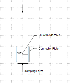

Just curious. Can you place the metal truss connecting plate on both faces of the beam, then glue the crack?

VQ/Ib is the theoretical shear stress at any point in the span. For uniform load, the spacing of fasteners should be variable throughout the span because shear varies linearly from a maximum at the end to zero at midspan..
The total shear force required between the bottom two laminations in each half of the beam is fb*A where fb is the average fibre stress of the bottom lamination at midspan and A is its area. For uniform load, it varies linearly as mentioned above.

If closing the gap is the question, then that is best achieved by placing intermittent pipe clamps from top to bottom of the beam just after applying the adhesive. Will close the gap and squeeze out the excess adhesive.

EDIT: After looking at r13's sketch, it occurs to me that the last comment (highlighted in orange) is wrong. Shear stress is maximum at the neutral axis.
BA
Shear and bending stresses in a beam, from text of mechanics of materials.

Correct... with rectangular beam it is a parabolic distribution... with average shear * 1.5 to give you the max parabolic stress... reason for the 1.5 factor in wood shear code. About 30 years back, in Canada, there was a bunch of delaminations... used to know the reason... but have forgotten...
