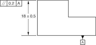

For the given parallelism tolerance, would you say that datum A constrains 2 D.O.F. or that it constrains 3 D.O.F.?
I can elaborate if you're curious why I pose this question.

That answer requires nuance between what we define as the DOF the datum feature itself constrains and in what DOF the tolerance zone is constrained. If we're going by ASME then 6.4 I think supports this. Ie: in your case your datum feature A constrains translation/rotation (u,v,z) but your tolerance zone is only constrained in rotation (u,v).
ASME Y14.5-2009 para 6.4 said:
Orientation tolerances are constrained only in rotational degrees of freedom relative to the referenced datums; they are not constrained in the translational degrees of freedom. Thus, with orientation tolerances, even in those instances where datum features may constrain all degrees of freedom, the tolerance zone only orients to that datum reference frame.
I am curious why you posed the question, while I think distinction/nuance in these matters are important - it is interesting to note how the distinction matters in an actual application.
I might as well tip my hand... I maintain that this constrains 3 DOF due to the nature of datum A itself, and I appeal to Fig. 7-3 of the 2018 standard as my basis. But others have said that it constrains only 2 DOF because this is an orientation control (not location), so translation along the Z axis is irrelevant.
I agree that translation is irrelevant to the measurement of parallelism, but I'm going with the ASME view on this.
My question was sort of a poll to see if any of you have heard this other viewpoint that a primary datum plane only constrains 2 DOF.
John-Paul Belanger
Geometric Learning Systems
This came about in a discussion with an associate here. It wasn't in regards to the application or interpretation (which is super easy for this drawing). It was a theoretical and semantics discussion.
Yes, chez, you hit on the nuance of the question. Since our discussion was on the datum, so I say that datum A indeed constrains 3 DOF.
But your reply gives me the wording I was looking for to explain this to my associate:  The part is constrained in 3 DOF, but the tolerance zone is constrained in 2 DOF.
I would simply say that datum A constrains 3 DOF, only two of which are relevant for the orientation control under question. Other controls may reference the same datum feature so the third DOF constraint is not canceled in any way.

If that part is thick, datum[&nbsp;]A constrains one degree of translation, and two degrees of rotation. I would not apply that as a primary datum unless the part were thick.
If that were a piece of sheet metal, then one of the faces should be the primary datum, and the datum feature shown would control two degrees of freedom.
In the context of your parallelism specification, then yes, only two degrees of freedom are relevant. My mind does not work this way. Translation remains irrelevant until I apply a profile or positional tolerance somewhere. Figure[&nbsp;]7.3 (Figure[&nbsp;]4.3 in ASME Y14.5-2009) is showing the meaning of the datum specification outside the context of a feature control frame.

Short answer - I would say that datum A constrains 3 degrees of freedom.
The Y14.5-2009 excerpt that chez311 referenced, particularly the bolded statement, makes this very clear. To me, anyway. Despite this, not everyone sees it the same way. I have talked to people at ASME meetings, including current members of Y14.5, who would say that Datum A constrains 2 degrees of freedom despite the statements in section 6.4. These clarifying statements only appeared in 2009 - in 1994 and previous, they were not present.
I remember discussions about whether or not customized DRF's duplicated the effect of composite FCF's. There was an argument that they did, and that composite FCF's could therefore be phased out. This argument was based on the idea that the datum features referenced in the FRTZF (lower segment of a composite FCF) only controlled rotational DOF's. The text in Y14.5 unfortunately left room for this interpretation, if one is willing to cherry pick certain statements such as this one that was still present in 2009:
"If datums are specified in a lower segment, they govern the rotation of the FRTZF"
