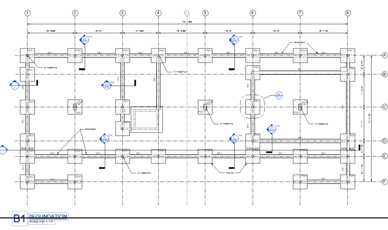

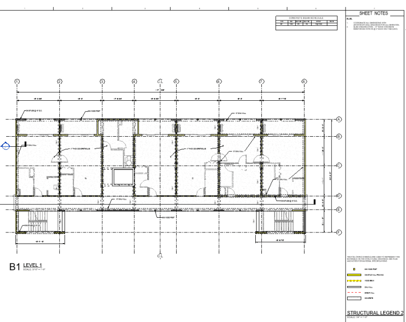

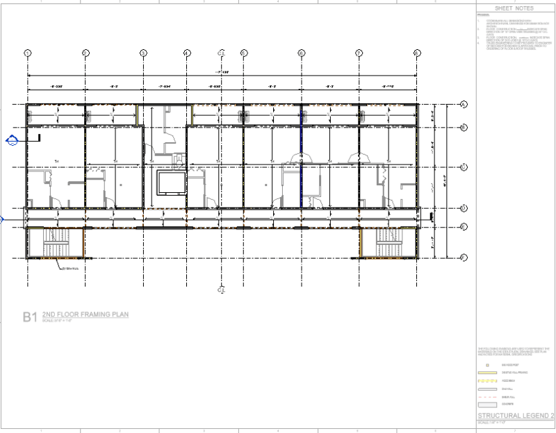

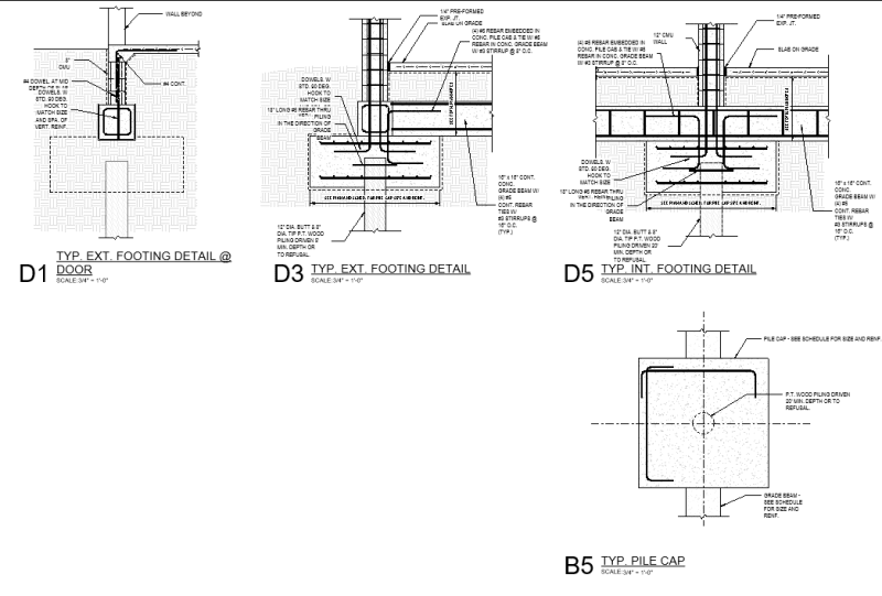

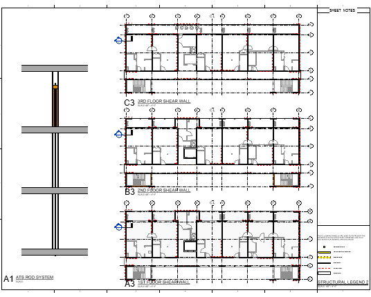

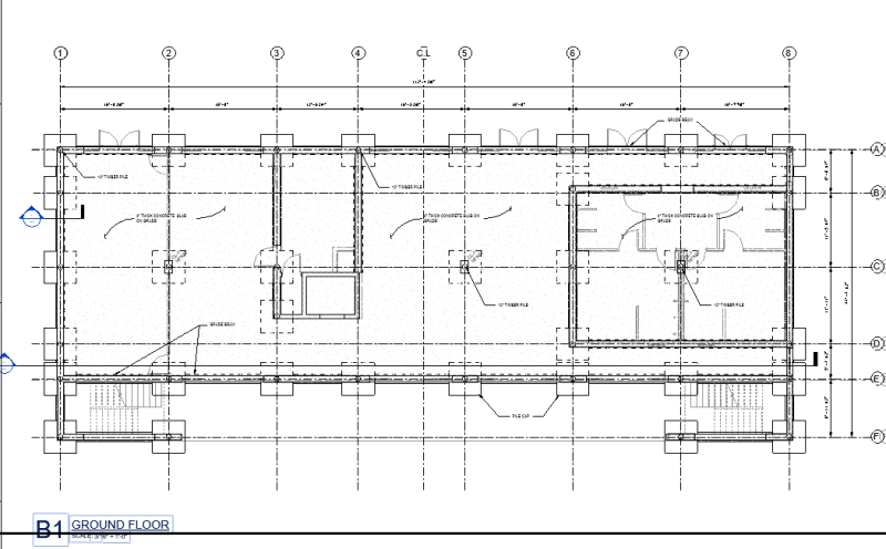

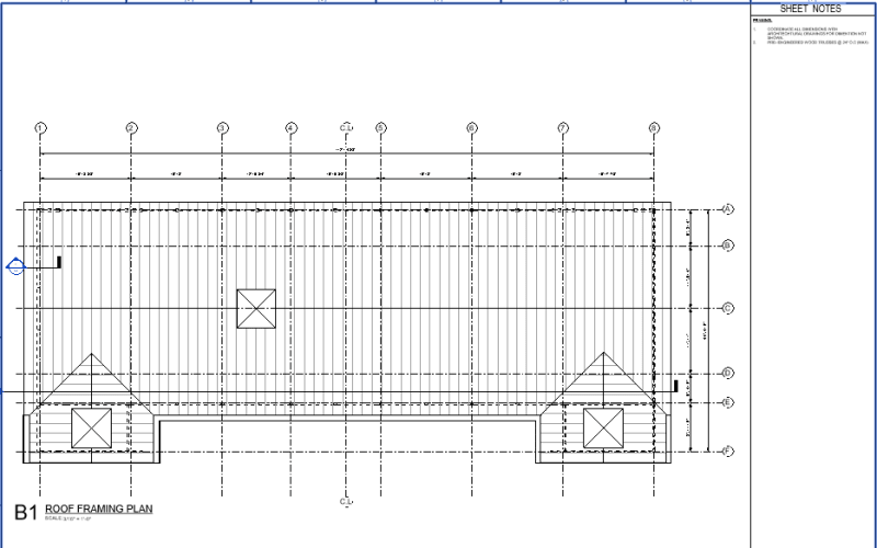

let me ask you guys a question so as I mentioned, I am working on a 3 story wood frame structure over a podium slab.
located at AE zone 140 mph wind speed first wood framing project for me since we don't use wood framing in Egypt first design experience with kind of wind speed.
first time working with masonry walls which exist in this project on the first floor and has to be designed to resist flood load. don't use it where I came from to basically we use concrete and steel.
in my office, they gave me this project to design and I am taking a long time because I am doing a lot of researchers to figure out all that new stuff for me. now they blaming me taking a long time knowing that I don't get any kind of guides because the PE engineer in the office is always busy so I cant get with him and his experience is more related to civil projects.
I want to know averagely how long should that type of project take? knowing that I am working on this project solo no other designers working with me.
I know my skills and I know that I can get it done but it will take that much time for me to get it done right.
any advice I don't have experience with the office work environment here in the states, appreciate your help.
 https://files.engineering.com/getfile.aspx?folder=788dcd4a-ff7d-4aa8-a9a9-19c735b1adb8&file=image004.jpg
@MHAGGAG85 can you share a screenshot of what the project looks like, it is difficult to put hours to a project only knowing the basic information you have provided? Project time is based on many factors, including experience, size of project, complexity, client, materials used, location, etc.
I hate hearing that you have been kind of left out on your own to design this project, I see this far too often, and in reality the EOR, presumably the PE you mentioned, should have an active role in the project. The more experienced engineers should make time to provide adequate training, especially to those employees who are actively seeking the knowledge as you appear to be on here, or should stop taking on projects that they are not adequately staffed for. While I don't doubt your ability to finish this project, you should definitely ask for some mentoring from the principal/project manager.
Here is some pictures, let me know your thoughts
Based on what you shared, accounting for only the project and no other variables (like client, how many times things will move around, learning, etc.), I would estimate around 100 hours for engineering + redlining and another 70 hours for drafting.
