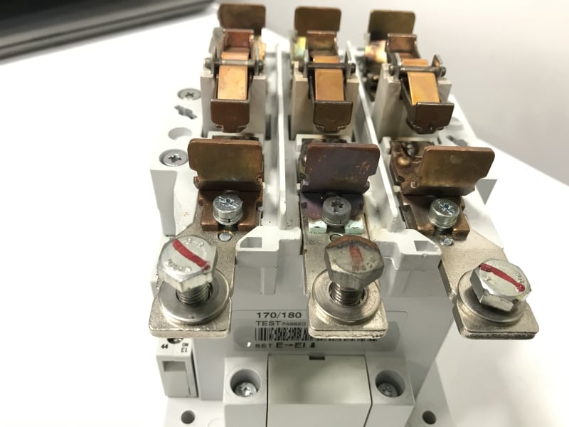

Looking at the attached photos, what's your first thought about what has failed? This cell set off an aspirated smoke detection early alarm. Heat damage (bad connection) or arcing damage (escaping from contactor) or something else?

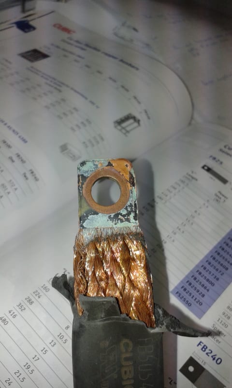

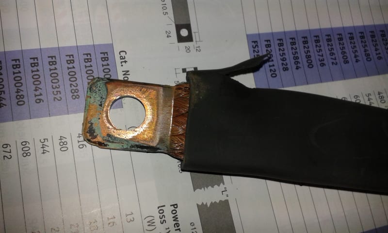

A couple of months later, I have gotten hold of the contactor from the photos at the top. It is now easier to see the centre pole at the end that was getting the most damage. The electrician that was repairing this thought that an arc was escaping from the contactor and hitting the cable connection.
You can see in the photo that there is a dark screw with verdigris underneath it. The other two poles are clean and the screws are bright. Also the bolt head face that is turned toward the contactor has some sort of burning.
The arc must be pulled between two arcing plates and then pulled or pushed into the arcing chamber area. These are seen in the second photo. It does seem incredible that the arc plasma could get out, and I am inclined to think it isn’t. I think that the marking on the bolt might be burnt PVC from those boots that were sitting over the terminals. I can’t see any evidence of an arc tracking from underneath the cover out to the bolt head.
So maybe the dark screw is due to the same high temperatures. I expect that the centre pole gets hotter than the outer two poles. I might have to disappoint the electrician with a report debunking his theories.
What else could be going on here?
I'd suggest that there is not enough air flow. Everything else looks pretty reasonable with spacings and a pretty robust design. Too little air flow to carry away the inevitable heat is going to leave the center leg hotter. With enough air flow that asymmetric temperature rise won't happen.

A strong possibility is a faulty cable.
If the stranded cable was too long in storage and then crimped without any measures to remove surface oxidation from the small strands, the heat may be generated internally to the crimp.
Also it may be well to remove the contact and check for signs of a heating on the bottom of the contact.

The cell fronts would definitely feel warm after some running hours. I can't see any extra heat effects on the fixed contact, centre leg, or the moving contact. The impression of extra heat is on the bolted connection area of the centre white phase.
Waross, these flexible leads are factory manufactured, the ends are forged under high pressure. Not sure exactly what they do, it may include a copper sleeve over the stranded wire, but the copper at the ends is looking like a solid mass as we receive them.

One consideration worth noting, that I've come across in a few installations, is that the maximum temperature of the terminals of some of those contactors is stated as 75 degrees in manufacturer's documentation.
However, most of the standards and calculations regarding cable capacity use either 90 or 110 degrees as the maximum conductor temperature. 75 degrees is not uncommon for some of the PVC insulated cables in use down under, but for most industrial installations this is ignored as its generally not an accepted practice to use the lower rated cable.
Noting that the photographs show overheating in the internal connection section under the cover, not just where the lug on the Cu-Flex connects to the contactor, it'd be worth reviewing the design documentation to see if there isn't a limiting temperature for the contactor terminals.
