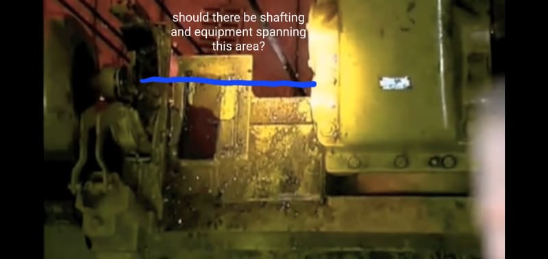

shows a bit more information(and more clearly). At 3:01, there's a shot of a "void", up in the crane structure. On the left, there appears to be a motor, and the remnants of a brake. On the right, a gearbox. And nothing in between. The span distance between the two elements is interestingly long. Maybe two feet.
One could wonder if there was a brake on the gearbox output.

At 3:01 on the left side is definitely the remains of a thruster actuated drum brake, clearly the the gearbox shaft failed. So was there a backup brake on the output side of the gearbox? The intresting thing about hoist brakes is that 99% of the time they are only a holding brake, the motor does the braking. It's only e-stops and other faults that would result in the brakes having to perform dynamic braking, which means if your brakes are not well maintained you can get yourself into a situation where the brakes hold just fine but fail in a dynamic situation (when you really need them to perform)
Cool Controls and Spalso, does this screen grab show the area you are describing as the remains of the drum brake?
Cool Controls - so there is a good possibility failure of the braking system which would have been in use by the crane operator as the rotor was being eased into place changed an uneventful installation into a major loss. In one of the links in the comments it is mentioned the facility was being unmothballed so there is a possibility the braking system had not been receiving regular maintenance - thus being in line with the cause for failure you have described. The lovejoy-type coupling shown with damage was collateral.
The crane was likely used to remove the old rotor, not terribly much earlier.
I don't see how that brake failing would cause the coupling shaft to disappear.
