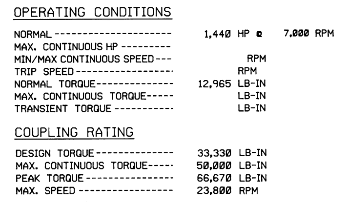

FYI Attached is an image of some information of starting torque of a motor connected to a high inertia rotor with a close coupled gear type (torsionally STIFF) coupling.

From JJ's post, it is typical to have the DESIGN rating of the coupling match the PEAK MOTOR TORQUE. Then you start putting in the safety factors, which results in COUPLING PEAK TORQUE capability. Usually, the COUPLING PEAK rating is related to the FAULT TORQUE of the motor.

Just to update you about the background, this Train originally had Shim Pack Coupling b/w Motor to Gear Box with Max. Cont. Torque 3.06 times full load Torque. This Coupling had Shear Pins designed to Shear at Torque slightly above Max. cont. Torque. However in order to address the Coupling Failures on this Train, this Coupling has recently been replaced with Torsionally Damped Diaphragm Coupling in attempt to eliminate possible Torsional Vibrations. Interestingly for the modified Coupling Max. Cont. Torque is 1.7 times normal Torque.
Also working on lines suggested by you, I have checked the Coupling Ratings on 3 other Three Phase Induction Motor driven Compressor Trains and the Motor to Gear Box Coupling in all 03 Trains have Max. Continuous Torque Rating exceeding the Peak Starting Torque given in Motor Curves. In fact in 02 of these 03 Trains for the other 02 Couplings (Gear Box to LP & LP to HP) the ratio of Max. Cont. Torque to Normal Torque is more than Ratio of Peak Torque to Full Load Torque given in Motor Curves.
Peak Torque Rating is above the Max. Cont. Torque Rating for all these Couplings but Couplings are designed to with stand Peak Torque for limited number of cycles probably meant to withstand fault Torque as suggested by Gr8blu
In nut shell my question is about having Coupling Maximum Continuous Rating equal to Peak Starting Torque as per Motor Curves not to have Max. Cont. Torque Rating equal to Motor Short Circuit Torque
