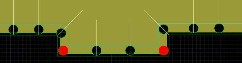

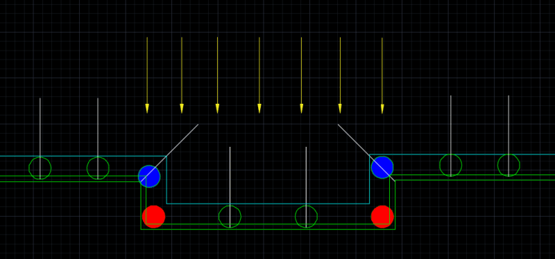

This might be a stupid question but I am going to ask anyway.
I have this layout of piers with anchors and there is no space to put anchors for corner piers (shown in red as below).
I am wondering can I not put anchors in these two piers since the adjoining piers with capping beam can already provide lateral restrain in global x & y for them? Is there anything I miss or need to carefully look at? Thank you.
