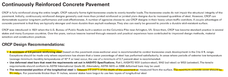

Well now I am in a bit of a rabbit hole on continuously reinforced pavements. CRSI recommends 0.6% longitudinal steel ratio, placed with a minimum cover of 3-1/2". I assume this means we can use 0.6% and split it between both faces.
Based on the information you are giving, it sounds like you need to follow civil highway PCC pavement design practice. This is actually pretty specialized design work. FHWA has a lot of good design reference guides on the matter. There are even software programs that will help you do the design. A 12" thick pavement is in keeping with the thicknesses you would find in a Jointed Plain Concrete Pavement (JPCP). This is sort of the standard nowadays. Some people still use reinforced panels but that is falling out of favor in most states.
In order to do this kind of design, you need to work closely with a geotechnical engineer that is familiar with this kind of work. They dictate the slab thickness based on the design of the subbase material and thickness given the maximum wheel load.
Jointing is the most important feature of designing PCC pavement (other than proper thickness and subbase design). Figuring out joint locations based on the shape and knowing when to put deformed tie bars or smooth dowel bars across joints is important. Many states use epoxy coated for dowel bars. Smooth GFRP bars are nice in lighter load situations but typically inappropriate for highway type loading. Stay as close to 1:1 with your panel aspect ratio as you can go. I would split the slab right in the middle in the transverse direction and go with 2 panels. In the longitudinal direction, I would go with 13 panels. PCC pavement concrete mixes are also normally specified by their flexural capacity which is different than other structural concrete.
You should be looking at ACPA, AASHTO, and FHWA for information related to concrete pavement.... I would not use CRSI.
