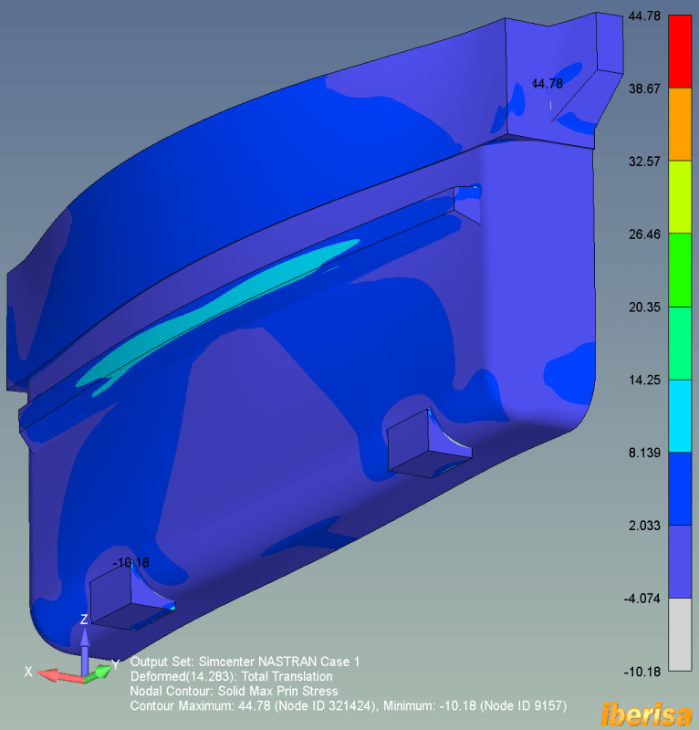

1.- Elements in grey: is simply the color levels of my legend, you can customize from F6 > POSTPROCESSING > CONTOUR / CRITERIA LEVELS > SET LEVELS. To plot the mesh quality use VIEW > ADVANCED POST > CONTOUR MODEL DATA > ELEMENT QUALITY
2.- SUPPORTING LEGS: supports are there, not supressed, are in the back side of the tank. I don't understand very well the question ...
3.- Applied loads are pressure + gravity + vertical load
4.- In my FEMAP model I don`t see such stress concentrations, check applied loads, mesh quality, etc..

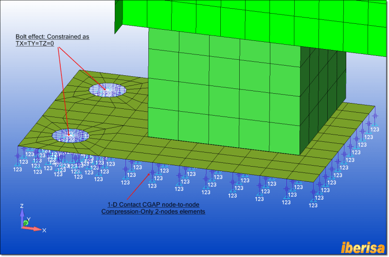

5.- CGAP elements are great, use them when you need to simulate supports working in compression only mode, nothing bad to see in this matter, I use them a lot as well, in the following picture you have a SHELL model with supports clamped to the floor using bolts, plus also added CGAP node-to-contact COMPRESSION ONLY elements.
