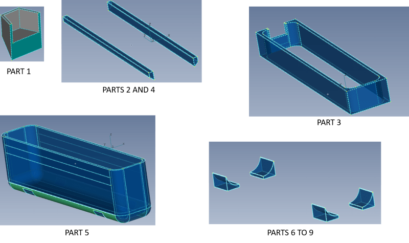

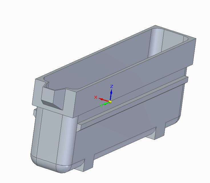

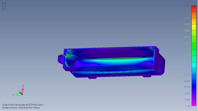

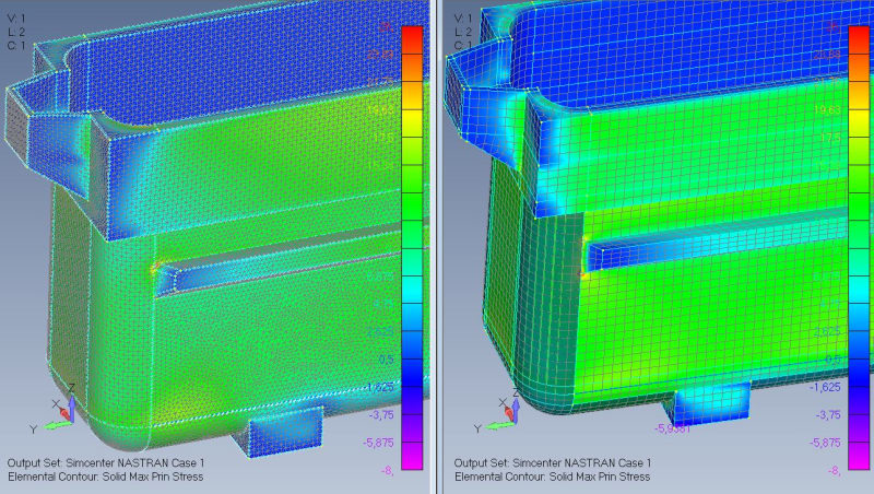

Definitely, it is better if I try to explain myself with an example (the file and images)... The geometry looks like the one in the next image:
I divided it into 9 pieces by using Femap's slice function, so I was able to mesh the solid easily in a better way (Jacobian less than 0.7). Next figure shows the 9 divisions:
Then, If I connect all the pieces through the automatic connection function of Femap, and setting up a spring connection, I get the following results:

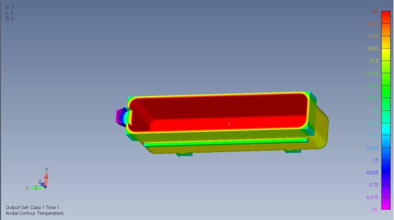

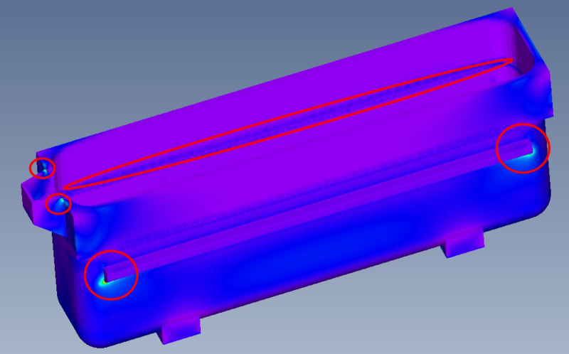

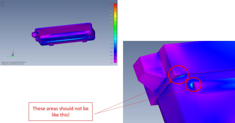

But then, if I apply a load temperature (first I run a Steady State Study and then apply a nodal load to the model):
It should be noticed in the last figure the areas enclosed within red circles in the zoom-image, which should not exist and they appear because of the definition of the surface-to-surface glue connection regarding to the Coefficient of thermal Expansion (CTE).
I have read that, by using RBE2 or RBE3 elements, I can input a CTE so this issue should be solved. However, when I try to implement this solution, I have no better results. The next figure shows the implementation of RBE2 elements in all connections but the supports (tank's legs, which are still connected by surface-to-surface glue connections). The pieces 1 to 5 are connected to each other by using RBE2 elements constrained at the three translational DOF's. The connections were made by using FEMAP's Custom Tool "Connect Nodes on Surfaces with Rigid Elements".
Even though when I choose the function "Spider Surfaces" from the Custom Tools menu, the software makes RBE2 elements (one for each pair of surfaces, total 4), but still results are pretty odd.
I have got to point out that when using RBE2 elements, I always activate the LAGRANGIAN option as Rigig Element Method at NASTRAN Bulk Data Options.
Even if I used RBE3 elements, results are pretty much the same and sometimes I have got errors related to double-dependence, since I have to admit that I do not know very well how to use RBE2 and RBE3 elements.

I ran other simulations with the same model but with small changes in its geometry. It seems that those small red areas are due to geometry and not to CTE or meshing issues.
Abrupt changes in geometry, especially in some areas with a 90 degree change produce this red areas. The next figure show a comparisson between the same model with a tet mesh of element size 25 mm and a hex mesh of element size 50 mm. In fact, if I compare only the tet mesh but with element sizes of 50 a 25 mm, I realized that the highest stress in those red areas increased, which indicated me that it was a singularity, something similar to the article:
It seems that I have to live with those singularities, especially when the design has those abrupt changes in geometry. Fillet those sharp corners would lead to bigger meshes and those small fillets and diameters are not 100 % identical to the ones presented in the real structure, so I guess that, in this case, it is better to neglect stresses in those areas, especially taken into account that the loads on the structure are static.

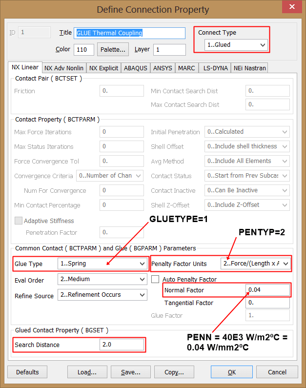

In this post I show how to control the parameters of the GLUE condition to deal with thermal contact properties, you will learn to play with GLUE types and penalty factors:

Great example and thank you for sharing. What is the "target value" you are looking for? And how did you determine this? I'm referring to the following sentence and later when you define the normal factor to 0.04. "Multiplied by e (PENN), this is e* kavg = 100*0.10838 = 10.838 W/m2ºC, which is almost 300 times bigger of the target value."

this is one big a$$ tank, if the mesh size is 50mm.
I think you have a mesh problem, with a sharp 90deg corner. Is this what you'll have in practice ? Surely (?) there'll be some corner rad ?
The other approach would be this indicates very localised plasticity, which may not be the end of the world. You're running linear FEA ? What material ?

"Target value" means the Surface Contact Thermal Coupling value defined at the beginning of the problem, is a know data, is directly the Heat Transfer Coefficient of the thermal contact coupling, precisely the target of this FEMAP tutorial is learn how to enter this value in the definition of the problem using the GLUE surface-to-surface condition:
Heat Transfer Coefficient = ksolder * Asolder / (Lgap * Achip) = 80*0.5/ 0.001*1 = 40e3 W/m2ºC = 0.04 W/mm2ºC
But you are correct, revising the page I note I made a mistake in units, where I say "e* kavg = 100*0.10838 = 10.838 W/m2ºC", the correct one must be "e* kavg = 100*0.10838 = 10.838 W/mm2ºC", the eternal problem with the units!!. The exact ratio is 10.838/0.04 = 270
But this value is not used in the analysis as I suggest to use the second method:
"For simplicity, I suggest to use always GLUETYPE=1 and PENTYP=2, which allows you to directly specify the conductance via PENN, having the units of (Thermal Conductivity*Length)/Area. Thermal Conductivity in SI has units of W/mºC, thus PENN has units of W/mm2ºC, i.e., directly the value of the Heat Transfer Coefficient of the Thermal Coupling."

I had already viewed the video about the S2S Glue Connections to analyze thermal problems. I tried to use this type of connection playing a lot with the pennalty factor but could not get to any good result which would not show me red areas. Actually, that video shows how to properly use that function to analyze heat transfer problems, but, is there any way to use it properly to study thermal stress problems?

The material is polymer concrete, let's say it is a brittle material, so no able to discard red areas due to plasticiy.
The tank I posted here is just an example, there are multiple designs are yes, they are big but maybe no so much.
Normally, I meshed them by means of tet elements, since they normally have some geometries that make the hex-mesh process very annoying or impossible. This example is quite simple, and I made it that way in order to be able to mesh it both with tet and hex elements in order to compare the results, and to check if the red areas were due the type/size of elements; however, the red areas where always present indepently of the type/size of elements.
Dependent on the tank design and size (they go from 1.5 to 3 meters internal height; 1 to 2 meters internal width; and 4 to 15 meters internal length) normally I have to use mesh sizes between 50 to 15 mm and the meshes go from 300K to 1500K tet10 elements. As I said before, I normally use tet meshes since it is too much complicated to mesh with hex elements on the most of the desings.
In practice, real geometries have many places with these abrupt 90 degrees changes on geometry, and maybe you would see some small radius but they are present mainly for aesthetic reasons or are too small comparing to the geometry that I decided to remove them from the model to avoid abrupt changes on mesh size.

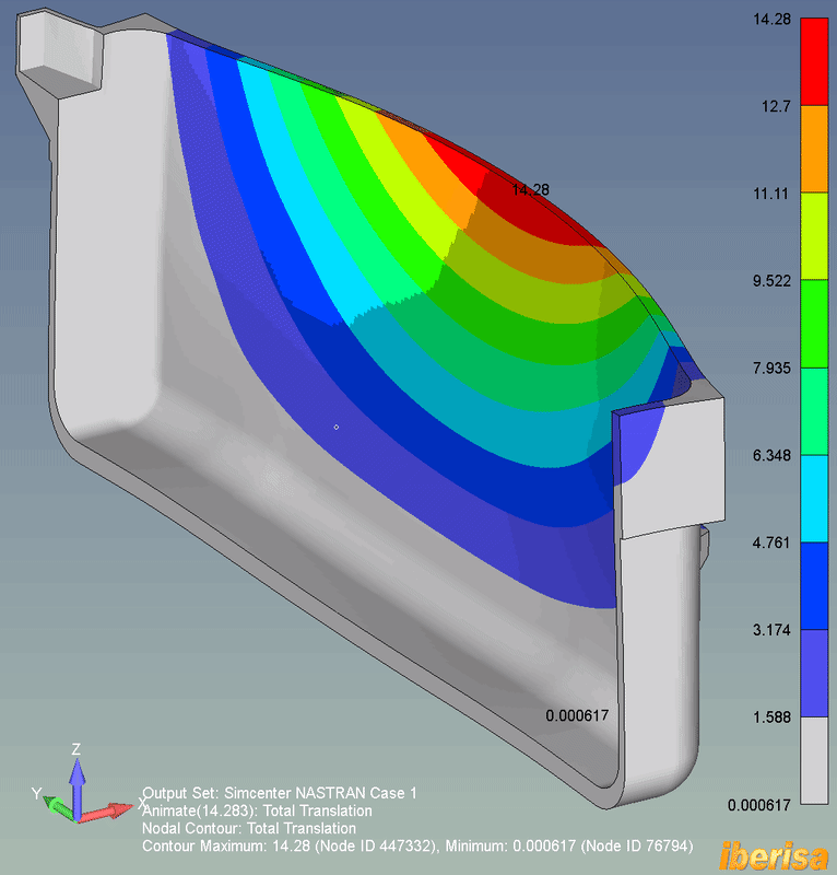

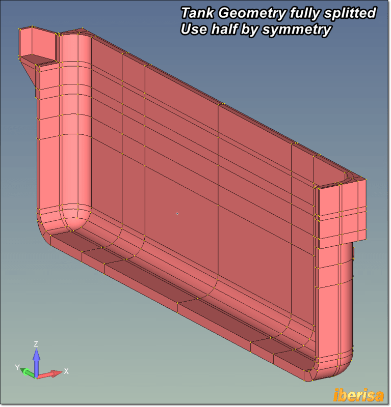

Dear Julio,

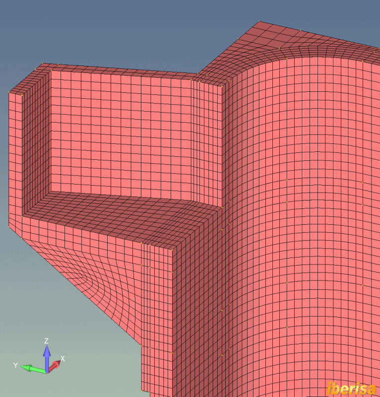

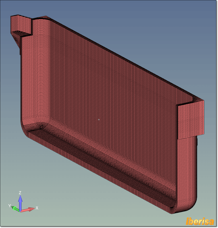

I have sliced the tank geometry, by symmetry simply use half geometry model, and half loading, of course!:

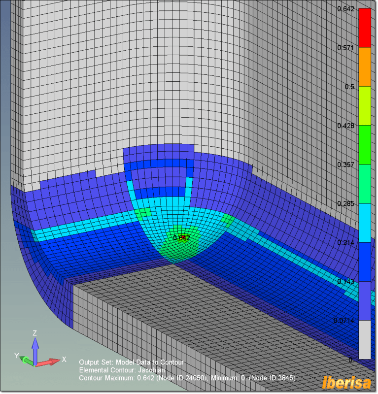

The model size is less than 275000 nodes, with a minimum of 5 elements in the wall thickness:
Some meshing details in the corners:

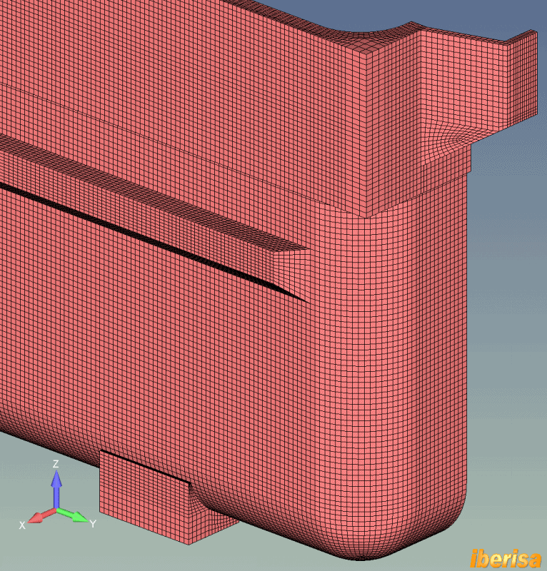

The key is simply imprinting curves in the middle of surfaces like shows the following image:

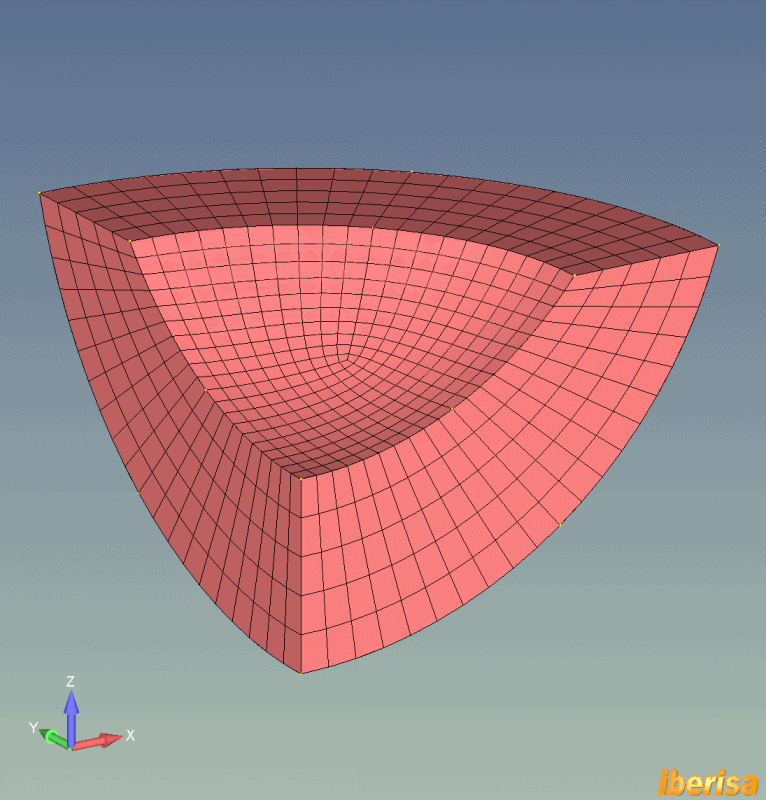

Also another interesting region, please note the meshing approach used here: MAPPED - THREE CORNER
And the following image shows the mesh & geometry in the back side:

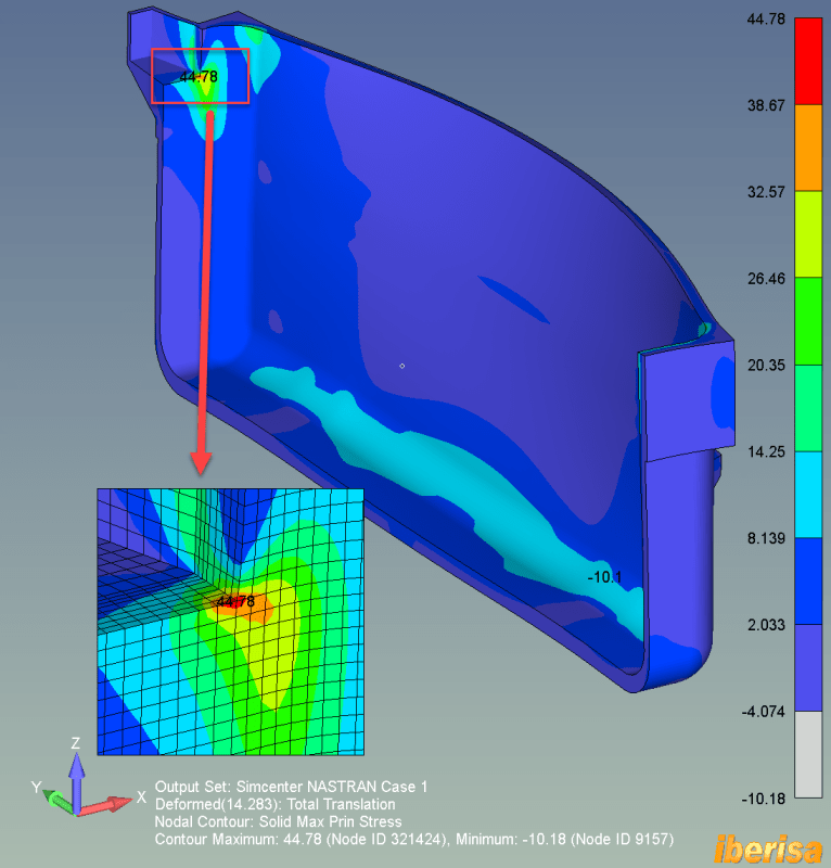

The following pictures shows the displacement results under the static loads:
The following picture shows the Maximum Principal Stress at traction (MPa) in the tank under the static loadings: the source of stress concentration is the geometry, the sharp corner causes a big stress raiser in that zone. Make a suggestion to designers to eliminate the sharp transition is geometry there.

Dear Blas!
Thanks a lot for your reply, you've given me really good tips to hex mesh this kind of geometry.
The symmetry tip is also very good, thanks! I have applied some times but in some cases I cannot apply symmetry since the loads are not symmetric (when applying seismic loads to only one wall, for instance).
I have some questions:
1) How do you show the rest of the elements in grey?
2) How do you supress the supporting legs from the contour visulization? Do you place those elements within another layer and then you don't show that layer?
3) Did you apply the thermal load (60 Celsius internal surfaces and a convective load in the external surfaces) or only the hydrostatic pressure and the vertical load?

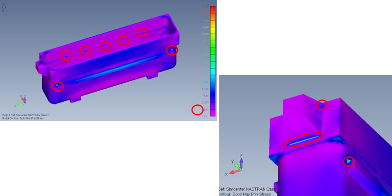

4) What about the results in the exterior such as the next image? Are there localized stresses (maybe less magnitude than the internal one that you showed in the last post)?
