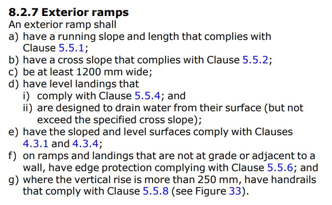

From an accessibility point of view? You'll want to utilize whatever governing standard the authority having jurisdiction has adopted. Here we generally use CSA B651 - Accessible Design for the Built Environment. If you're asking about the concrete design itself then I am not aware of anything (outside of usual state / provincial sidewalk ramp standards), but it's no different than any other typical wall/slab design.

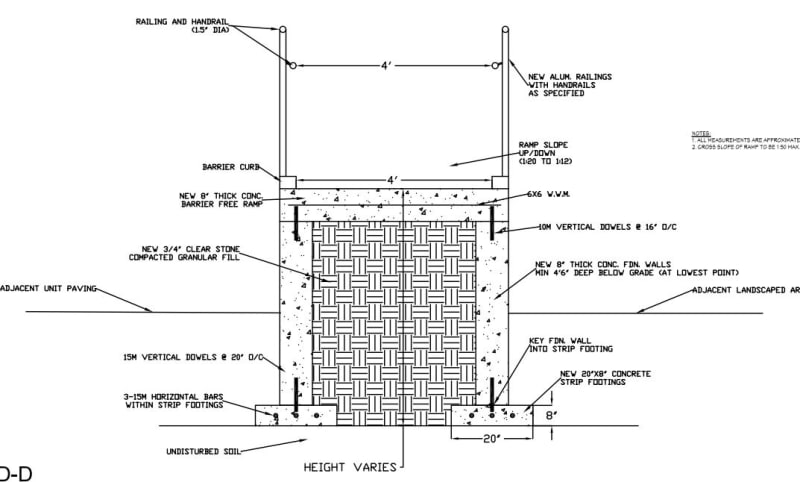

Shux, I am less helpful in the regard. No guides but you may find the details below useful.

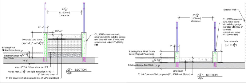

In my experience I've found things run the gambit from complete independence (walls with footings founded below the frost line and slab on top) to completely floating / entirely on-grade systems. If you look at the project details below I think you'll find that people just kind of make up their own thing.
City of Winnipeg ramp detail
Details from a community housing project I bid on as a concrete contractor a few years back

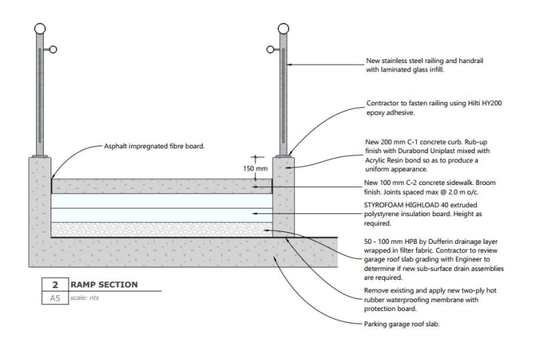

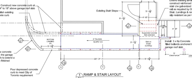

Details from a project I was awarded where we put a ramp on a suspended parking garage roof deck

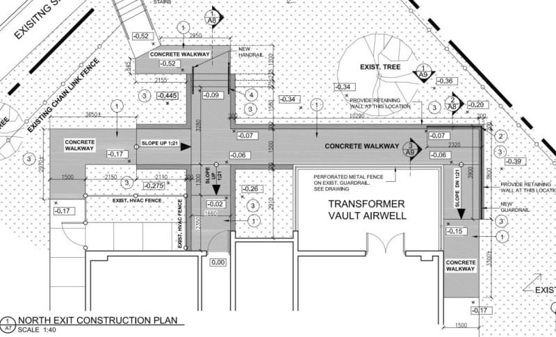

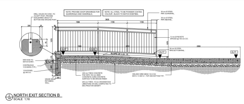

A few other details from other misc projects

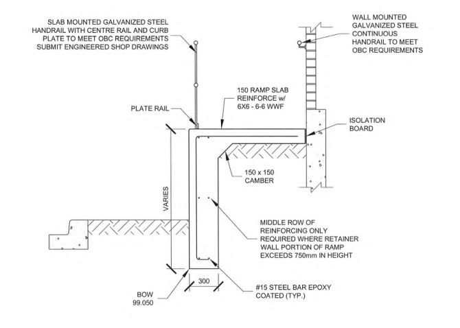

Enable, this was exactly what I was looking for. Thank you, the examples are excellent - in particular the 4th picture. We're in Ottawa so our winters are usually harsh (not this last one, however) so I am worried about heaving. I will go with walls and footings extending below frost depth over any floating versions. Thanks again.
Picture 4 looks good. Picture 5........not so much. Picture 5 looks like a wall without a footing to me.
