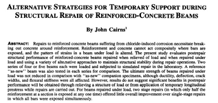

There is a pair of papers by John Cairns (one in 1996 in the Journal of Structural Engineering and one in 1993 in the Journal of Civ. Engrs Structs & Bldgs) that compare beams that were repaired under load to those that were actively relieved of load and repaired. The results more or less turned out to be about the same for strength indicating relieving the load prior to repair was not necessary (though ductility and other aspects were affected, as you'd suspect). That said, we generally just don't do it in practice because of the expense involved.
