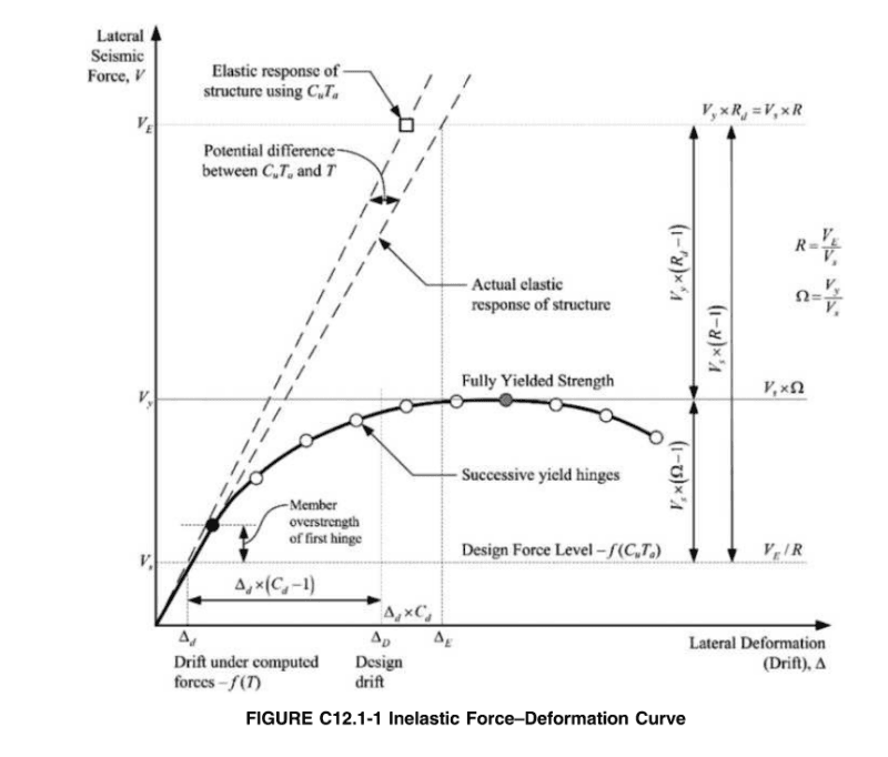

R is response modificatin coefficient. ( A measure of performance of the SFRS .Refer to FIGURE C12.1-1 Inelastic Force–Deformation Curve )
Refer to ASCE 7 -16 Clauses 12.2.2 and 12.2.3

You could decide to designate some frames as not part of the seismic force-resisting system. But those frames will still need to undergo the same story drifts and associated deformations as the moment frames. So you will probably end up providing similar detailing as the moment frames anyway. Refer to ACI 318-14 Section 18.14.3 for more information.
