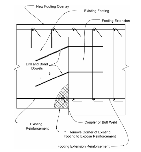

Due to increase in load on existing structure, I need to increase the size of the foundation (combined footing) and the concrete pedestal through concrete jacketing.
I am looking for ACI code provisions for design of shear keys such as diameter of holes, depth, spacing, shape of bar etc.

I'm doing this kind of retrofitting (i.e., concrete jacketing) for the first time, so I wanted to make sure I was doing it right and as per code provisions.
I'm mostly concerned whether the anchorage of the shear connector in the existing concrete will be sufficient to provide a monolithic type of connection between the new and old surface.
The research reports I've read give very sparse information regarding the anchorage. Most just instructed in a paragraph to make sure the anchorage is properly designed to transfer the shear between old and new concrete and some mentioned to provide a min embedded length of 6db for connectors.
For a 12Dia bolt this give a min length of 72 mm. Which seems to be a very small length, even though the shear transfer by a rebar will not be very large and at maximum will be equals to the shear strength of the rebar.
But I do think that a rebar of this small length can easily slip. And, this will become a definite possiblity if the drilled holes are not properly cleaned before application of epoxy bonds.
On the other hand, if i provide a length equals to development length (approx equals to 28db), this seems like an unreasonably large depth.
From similar past projects designed by my firm, provided detail of concrete jackets have 60 ksi anchor rebars embedded in an epoxy filled hole, which has a diameter = db + 2mm and length of 200 mm. And so far no problem has arisen or brought to our notice from those projects.

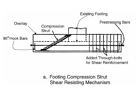

The retrofitting for shear strength deficiencies are difficult. Lets use strut and tie analogy… In order to develop diagonal compression strut, the existing bottom steel shall be tied to new with welding or coupling…and the new rebar anchored with 90 degree hook.
Other measures , increase the footing depth with concrete overlay…and the use of prestressing rod.

It is shear friction reinforcement, which is covered in ACI318 CH-11. Hilti provides epoxy grouted rebars with design information, you can check out on its website.

The concern is the lack of proper anchorage for the dowels..It is only recommendation to consider the 50 percent of the effectiveness of properly anchored stirrups, dowels..
