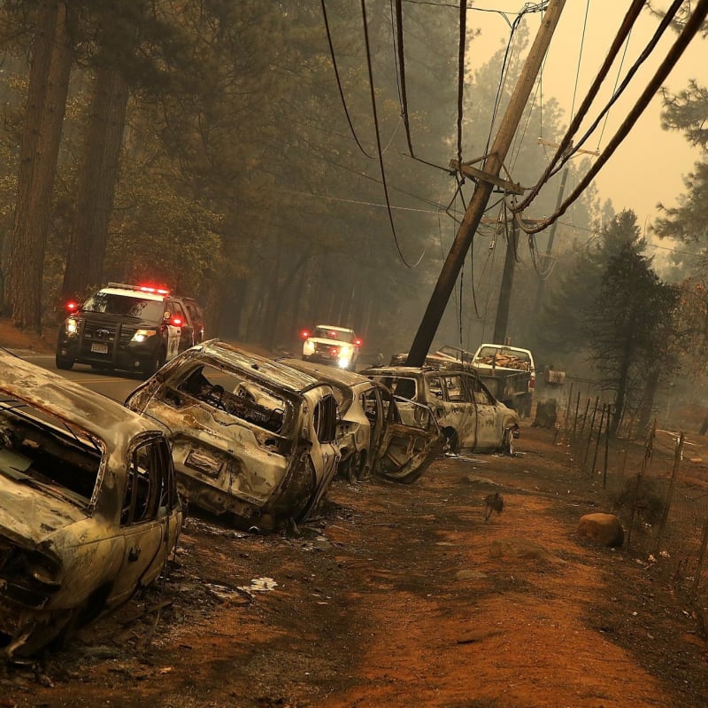

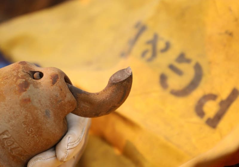

Ah, Con Edison must be understudies of the true masters of rotting infrastructure. PG&E
Keith Cress
kcress -
Wow! Is that the line bracket which failed starting the campfire? That is bad, though I am not surprised.

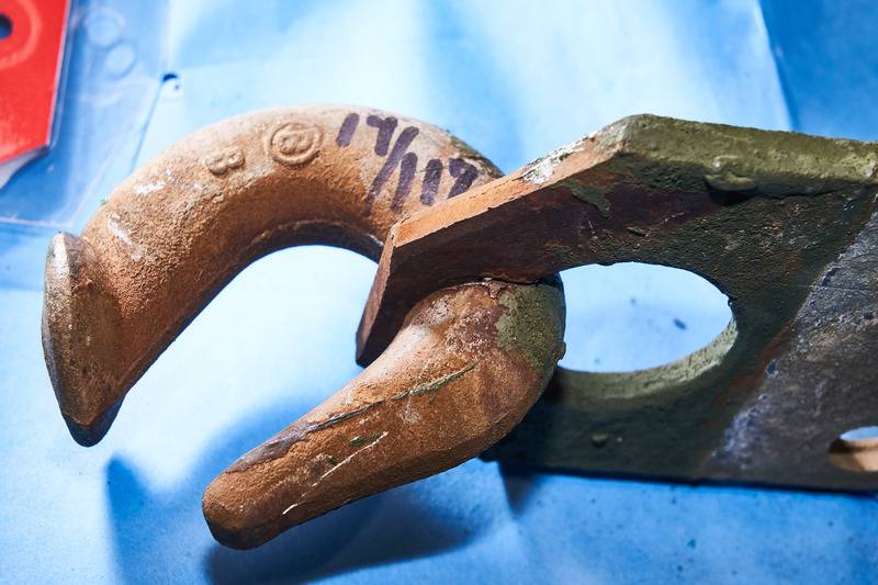

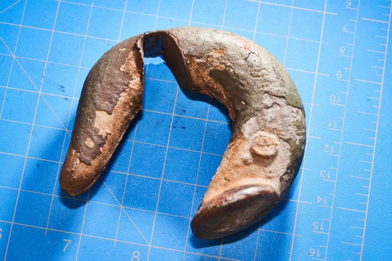

Mbrooke; Yes the bottom one in front of the "PG&E" caused the camp fire.
I understand they still have hardware in service in the same area that is in the same shape as the top pictures.

@Itsmoked- I knew it was bad, I didn't know it was that bad! I can't thank you enough for those pics.

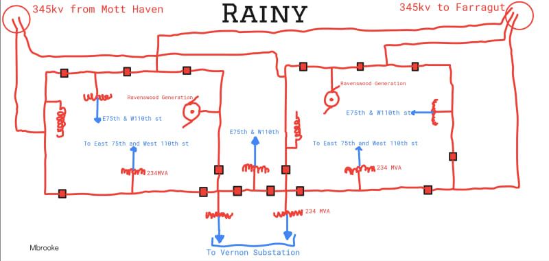

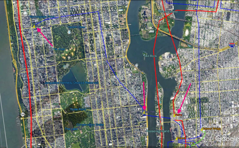

Regarding the latest incident judging by the outages my best guess is something happened at Rainy causing transmission supplies to East 75th st and West 110th st substation in Manhattan to drop.
Here is a transmission map- blue into Manhattan is 5 radial 138kv (sub)transmission lines, blue into Vernon is two 138kv (sub)transmission lines, Red is 345kv lines (two from Mott Haven in Bronx three from Farragut in Brooklyn) plus Ravenswood generation interconnects into Rainy:
Singe Line of Rainy:
Reports of flashes in the sky before or during the outage:
So I'm now left wondering what was behind this event? Setting my watch for the next set of transmission outages. [colorface]
