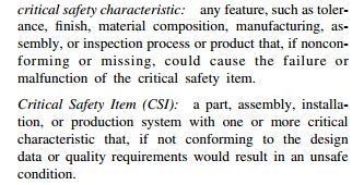

The use of critical dimension / characteristic concept most likely varies between different companies, but from my experience it's often related to safety. I don't have the latest Y14.100 handy, but here is a screenshot from 2000 version of the document:
In the company I work for we would use 3 different "critical" symbols, if all three characteristics were truly critical. That is mainly because there is a characteristic number (CN) tool in use that automatically flows down all the drawing requirements to a characteristic report. Each of the three characteristics would have its own CNs and if only one of them had the "critical" symbol assigned, only that one would be seen as critical in the characteristic report, which would be against the intent.
