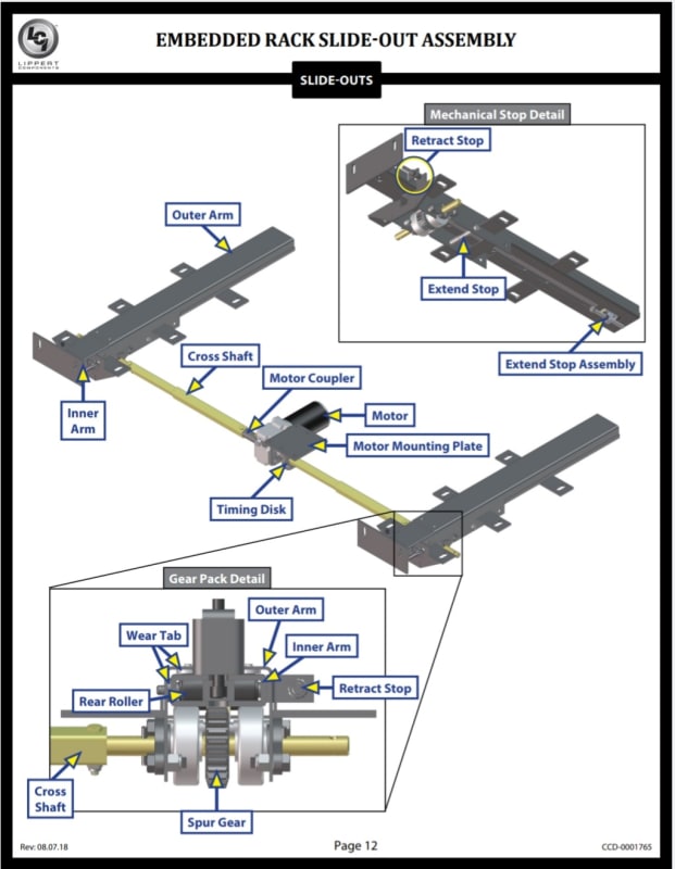

I need to design a mechanism to move a load horizontally. So, I came up with two choices viz. Telescopic cylinder and worm and rack arrangement. Which one will be more efficient in terms of operation and cost?

@MintJulep, depending on the client it will be done once in a while. We are assuming once in a year. It needs to be pulled and pushed so winch is not an option.
@Jboggs, the chain loop is a good idea but we lack support underneath. The whole setup will be bolted to a wall of 3" thickness. In the chain loop system motor and gearbox moves along with the sprocket. Too much moving load. In rack and pinion, rack alone moves so, it is preferred.

There is a rectangular block of 10 ton load. It needs to be pushed or pulled around 15 ft. The load will be moving on rollers. Now I need a mechanism which can do the above task as frequently as once in a year maximum. This whole mechanism should be mounted on a concrete wall of 3" thickness parallel to which the load will be moving. There will be two such walls so two mechanisms. Alignment is very crucial here.
This load and walls and the mechanism are actually a part of a portable product. This whole thing can be deployed anywhere from a well established and levelled concrete or metal platform to the fields of Savannah. So there is no guarantee that I will get proper base to fix some equipments in front/behind of the load to pull or push it.Nevertheless, our product will be first deployed on a well established metal platform for the first time. This platform is just as wide as the load and the walls. By the way, the load will be in between the walls. So there will be no support beneath the mechanism for now. There will space at front and back though but that may not be the case all the time.
Whatever the mechanism is, it might be operated multiple times to get the load in right position (for rack, cylinder, chain loop, etc.). Because the chances are that this mechanism will come fitted from the factory itself and there is a 8ft width restriction for any article that is to be transported by road. So the maximum length of the rack can be 8ft only.
Now the most baffling thing is there may not be any crane at the deployment site. There are trucks that has a loading and unloading system so I guess it will be used to unload the whole product. But that's about it. It can't do anything about the mechanism. So the mechanism should have structure that is easy to move up/down with a chain block. And there will be 4 to 5 men to deploy this whole thing. At least that's what I've been told.

There is a 10mm gap between the wall and the load. It should remain the same. Basically the side of the load must be parallel to the wall.
Sounds like a recreational vehicle slide mechanism.
Ted
