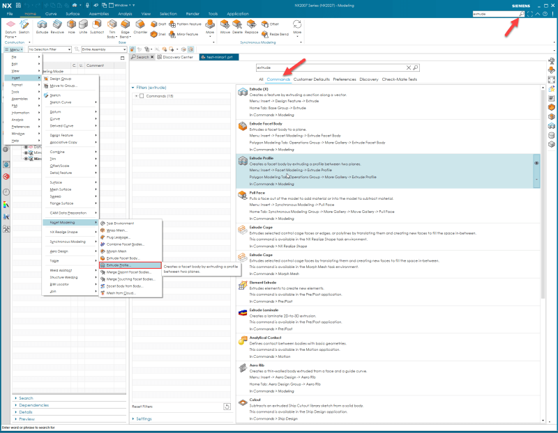

NX2007, when I search for a command, I can open it from the search window, but I want to see its path in the main drop down menu's, so I can include in my toolbars.
It used to show you where to find the command but now it doesn't.
I've looked all over customer defaults etc but haven't found a solution.
Can anyone help me?
Don't select the command. Instead click the magnifying glass in the search bar, this will bring up the new search.
Change the selection from All to Commands, then highlight the command and it will show where in the menu or toolbar it can be found (see image).

Thanks Anthony,
that's two in one day (the other one is the F8 mirror)
