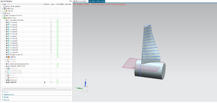

Hi, I'm learning NX and I have some questions about the Through Curves command. I want to model a compressor blade based on the different airfoils along its span. However, when I use the command, it generates a sheet instead of a closed solid. I’ve seen some posts here where people manage to create a closed surface even with an open profile using the same command. I would really appreciate it if you could explain how!!" Not doing for me. Just explanation!
In the "settings" section of the dialog, change the "body type" option to "solid". If possible, a solid body will be created. I think the section curves need to be planar, closed loops for it to work, IIRC.
When working with the free-form surfacing commands, it is common to create sheet bodies then sew them all into a solid at a later step. Sometimes this is an easier workflow.
Also, you shouldn't post the same question twice.

I tried that. But I get the same result.

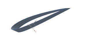

Are the section curves closed , end to end or is there a gap ? - Use the measure function and measure minimum distance from the end points.
NX is very precise so if there is a gap, it needs to be very small for NX to "bridge" .
Try turning on preserve shape. This may help a small bit.

The ends of the curves are not closed.
