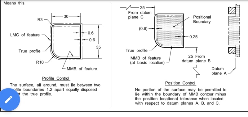

Here is Figure 8-24 from Y14.5-2009, with an additional position tolerance added:
The additional callout refines the relationship of the feature to Datum A.
Is this a valid application? ;^)

If you wanted to convert the combination in Fig. 8-24 to a single profile tolerance to A|B|C, I think that the tolerance value would have to be 2.85. So the FCF would be [PRF|2.85(U)0.85|A|B|C].

If we consider the Virtual Condition (max. material) boundary and the Resultant Condition (min. material) boundary, i think the distance between them is 1.45; the RC is at distance of 0.6 from the true profile. The VC is at distance of 0.6 (half profile) + 0.25 (half position) from the true profile. Total width of the profile tolerance zone (per my proposed alternative) is 1.45. The portion allowed to be outside the material relative to the true profile is 0.85.
Here is the graphical depiction of the tolerance zones from the bottom of the figure:

As far as your numbers I see where Evan is coming from but I think it actually falls between both of your proposals - I would say the total tolerance zone should actually be 1.7 as the additional position tolerance would allow the entire 1.2 original zone to shift 0.25 up to the "positional boundary" which actually would increase the size of the tolerance zone on both sides - so the total zone increases by the full position tolerance. So in this case it would still be an equally disposed profile tolerance of 1.7 - at least I think.
I think i'm also starring starting to understand where Evan is getting at and per my last calculation it is actually 2.9!
Consider the widest feature allowed per the 1.2 profile FCF segment at the direction of 30 basic dimension, and put it in a location where it contacts the positional boundary on the right side. Now check where the left side of the as-produced profile reached. That scenario is widening what i previoulsy was considering the RC boundary.

I think you may be correct, the combined control is really throwing me off as I'm not considering the bonus tolerances allowed by the MMC position callout for a feature of LMC size. Its safe to say though that this would not be "equivalent" because as opposed to the profile/position combined tolerance a single profile control of this size would allow a much larger (and smaller) feature. This would have to be changed to a MSS or composite profile tolerance to get a similar control - albeit without the ability to apply MMC/LMC and without available bonus tolerance.
Chez311:
Here is what i would currently consider a tolerancing scheme exactly equivalent to the one shown in fig. 8-24:
[[profile]][2.9(U)0.85][A][C]
[[Profile]][1.2]
The second segment is of course a refinement of the first one.
I even think it could be gaged/inspected in the same way despite of the fact that technically the term MMC can't be used in regards to the composite profile.
Objections?

I'm trying to think of a way to disprove that as it doesn't seem like we should be able to get the same result without position at MMC, however it looks like the tolerance zone would behave in almost exactly the same way - down to replicating the behavior of bonus tolerance afforded by the position control in the example 8-24, without technically providing bonus tolerance obviously as MMC/LMC cannot be applied.
Perhaps it comes down to the fact that the tolerances in the FCF's must be exactly matched to provide the proper behavior - any mismatch (ie: one or both too large/too small vs. the other or improperly distributed) and the behavior will be different vs. the boundary concept provided by combined position at MMC/profile tolerance. This will work out to a pseudo-"bonus tolerance" that will not work out correctly or intuitively what we're used to with standard MMC/LMC bonus tolerance with position.

Here is how I see it:
I used slightly more regular contour than the one in fig. 8-24, but I believe that this should not change anything when it comes to drawing a general conclusion.
There is one more interesting observation to make, in my opinion. In the profile/position combo scheme, if one or both tolerance values are big enough to allow the actual contour to rotate more or less freely about the MMB boundary (in a similar way to what I have shown in the attached document), this may lead to some unexpected and undesired consequences.

pmarc - isn't the 10.1 value on sheet 2 the size of the Resultant Condition, not the LMB?

I decided to use term LMB instead of Resultant Condition just like I used MMB instead of Virtual Condition. I guess I could also call them Inner Boundary and Outer Boundary.*
The key thing here is that the 10.1 dimension is not really the true size of that extreme boundary, regardless of how we will call it. The figure on sheet 3 shows that the extremities of the toleranced feature can reach farther than just 5.05 (10.1/2) from the true position. That is why I think the idea of conversion of profile+position combo to a composite profile by calculating size of the extreme outer boundary based just on a possible translation of the feature is not a good idea - at least not for features other than circles/cylinders.

I hope it is not too late to get back to Evan's original question about the orientation refinement. What is not so clear to me is - since the 0.2(M)|A position uses the boundary interpretation to refine orientation, how will the boundary look like in this case? If it should be at uniform distance of 0.1 from the MMB of the complex feature, will it not make the positional boundary of the second segment (at uniform distance of 0.25) redundant?
Edit:
I made a check by myself and discovered that the position tolerance WRT datums will not be redundant, because the refinement position boundary floats together with the profile tolerance. However, I also discovered that the resulting tolerance zone of the orientation is not obvious from the specified value and it actually equals the profile tolerance+ half of the position tolerance refinement. Attached is a sketch displaying it. I modified the tolerance values to make the zones more visible:
*profile is within 2.
*position WRT datums A,B,C is within 1.4.
*position as orientation refinement is 1.
Displayed is one possible location of the tolerance zones. The dashed thick lines are the profile tolerance zone, the dashed orange thin profile is the refinement boundary, the continuous internal profile is the virtual condition boundary established by the position tolerance WRT to the datums. Maximum orientation deviation is 2.5. I find the fact that it's not directly accepted from the refinement FCF disturbing.
Edit: if my analysis is correct, the "refinement" tolerance zone ia actually larger than the Profile specification used to define form. Then it is not really a refinement. I would currently answer Evan that it's not a good application since it fails.

Two things:
1. As you correctly noticed, the MMB boundary created by the position callout wrt A is not redundant because it can translate toghether with the profile tolerance zone. The only relationship to datum plane A that is actually controlled by that callout is perpendicularity. So if the only relationship is perpendicularity, the question is, does it make sense to use position symbol at all?
2. As for your sketch, look at it again and ask yourself what the maximum possible orientation error could be if there was no "position of 1 orientation refinement" callout. And keep in mind that no one said that this extra callout was form refinement. Orientation requirement is what we have been talking about.

1. I would say the answer is no. For orienation refinement, my choice would perpendicularity of "each line element", I'm with CH on this matter.
2. I would say the maximum error will be 2, as dictated by the form control (Profile).

I think that there is a place for both. Composite profile is more stringent requirement, but that does not mean that profile + position @MMC combo should not be the preferable choice in some cases. The combo in case of irregular features of size is a similar technique to applying position @MMC to directly toleranced regular features of size (pins, tabs, holes, slots), except that in case of the combo the size and form is controlled with profile tolerance and not with Rule #1. There are certain risks behind using it (the unexpected behavior under certain specific conditions that we talked about), but that does not always disqualify it.

1. Perpendicularity of "each line element" does not result in the same geometric requirement as the position/perpendicularity tolerance @MMC wrt A, so I am not sure I understand why you add it to the conversation. In case of perpendicularity of "each line element", regardless of the feature size the amount of available perpendicularity error would have to be the constant. In case of position/perpendicularity tolerance @MMC wrt A the possible amount of perpendicularity error changes (increases) with the increase of the size of the feature.
2. Incorrect. The maximum possible orientation error (for feature at LMC) would be 2.5. I guess you said 2 because you assumed that the profile tolerance zone is perpendicular to datum plane A. That is not what the profile tolerance is saying.
I made a typo in my last reply. There should be 2.7 instead of 2.5.
