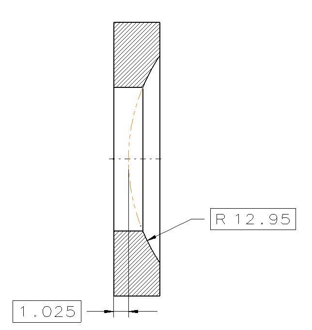

Hello everyone,
I'm overwhelmed by the amount of information regarding GD&T profile and I can't seem to find my answer here (or I got exhausted trying to understand all the information)
We have a small part with a sphere surface.
Based on ASME Y14.5-2018 is this dimensioning correct?
I'm currently modeling an assembly with parts at MMC to check for intersections and functionality. But when I looked at this drawing I got confused how to calculate the maximum material condition. (i.e. smallest sphere size)
Is it true when the sphere surface is at it's minimum size, the form has to be perfectly spherical, which is impossible to achieve?
Does the 0.05 profile refine the size tolerance? For me, it's confusing because if I go down in size, for e.g. at 12.92 I could no longer have a 0.05 profile tolerance.
Would it be reasonable to control the size, location and form with only the surface callout and basic dimensions?
Like |profile|0.05|A|B| and |SR13| and theoretical shpere center |14| are basic.

Regarding gaging, note that if you implement the profile tolerancing method, you don't really need the gage ball. That is because the dimension from datum A to the sphere cener 13.975 is now basic, and the combination of basic dimensions 13.975 and the SR 12.95 only serves to locate the tolerance zone for the surface relative to your A, B datum reference frame. And this happens without any intermediate influences or tolerance accumulation that could result from the gageball imperfection. As a matter of fact, you could replace the basic 13.975 by the basic 1.025 which I showed below, or tie the spherical surface's "true profile" to datum A by any other combo of basic dimensions that you like, and it would mean exactly the same thing. This is a major part of the advantage gained by implementing the best practices of dimensioning and tolerancing. You are using the CMM anyway, so why not use it more effectively? How about trying to promote this in your company for reduction of time and costs?
Since sealing is the goal, using an air gauge would be the more typical approach. It would take a few seconds to validate the part rather than tying up a CMM for a much longer time. CMMS are great to see if parts fit - they are not good for confirming how well they perform.

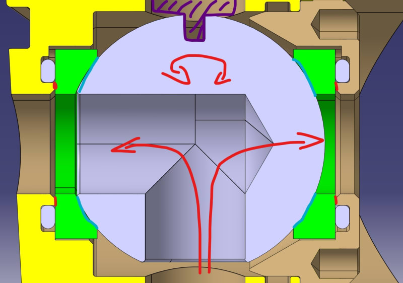

Per the OP's description in his post where the assembly image was added: "The function of this part is holding the ball in place and sealing the system". If green parts (the seals) hold the spherical valve in place, the spherical valve is located to the rest of the assembly by the seals and not vice versa. As long as the assembly mechanism ensures face contact between the flat face of the seal opposing the spherical surface and the thin flat face between the O-ring groove and the passage hole on the mating components at both sides regardless of the as-produced spherical diameter of the valve, the flat face is what locates the seal in the axial direction and orients it in two rotational degrees of freedom. Therefore the flat face should be kept as the primary datum feature and the OD, which locates the seal in the radial direction, should be kept as the secondary datum feature.
You didn't look at the diagram, so you didn't see how it works.
The diagram shows face contact.
In the opposite case, the seals would be floating between the valve and the o-rings, and the rate of compression of the o-rings would depend on the size of the spherical valve. Not likely that this was the design intent.

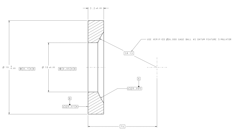

I made another drawing with your suggestions (using sphere as Datum feature A)
Am I interpreting your idea right?
Yes - do the costly precision forming and polishing of the spherical surface first, checking it with dye transfer and then surface grind the back side on a jig set on that sphere. The perimeter and hole are just clearance features that can be done before or after. There are advantages and disadvantages to the order of the clearance surfaces.

Your last drawing uses the spherical surface as the primary datum feature and the flat face as the secondary.
This means that the spherical datum feature and its simulator are intended to constrain 3 translations, and the flat datum feature is intended to constrain 2 rotations for the controls that reference the |A|B| DRF.
If I was to look at this from a general tolerancing perspective, regardless of specific considerations related to CMM inspection, I would say that there are some issues:
First, that relatively small strip of a partial internal sphere with a relatively large spherical radius is not a good candidate for preventing translations at the two directions perpendicular to the axis.
Second, the secondary datum feature is profile-located to the primary datum, and the datum feature simulator for the flat face will need some level of adjustment within the profile tolerance to mate with the actual surface. This is a complex concept of datum simulation that wasn't even defined until the 2009 edition of ASME Y14.5 in paragraphs that refer to figures such as 4-30 (7-32 in the 2018 edition). So depending on the level of compatibility of the inspection software's computation methods with the definitions in the latest editions of the Y14.5 and Y14.5.1 standards, this datum referencing scheme may cause trouble with the CMM inspection too.
Your selected datum features and their order need to be reliable in the constraints of degrees of freedom they are supposed to provide, but first and foremost - they need to be functional for the use of the part. Does the constraints of degrees of freedom as described reflect the assembly conditions? If not, reconsider them.

In a mechanical ball joint, the socket locates the ball relative to the rest of the mechanism and not vice-versa. The features that locate and orient the socket are selected as datum features. I know you are always upset over opinions that differ from your own, but my response was addressed to Wuzhhee and not to you, so your over-reaction seems out of place.
I did mention though that I was commenting on the drawing detail generally and not specifically in the context of CMM, the use of which by the way doesn't exclude physical datum feature simulators that still need to constrain the part. The CMM might find the center, but the part could move relative to it. Regardless, a drawing should specify requirements that can be evaluated by multiple inspection methods. The CMM doesn't cancel datum feature reliability considerations.

The tolerance stack of the components always results in a small gap so the ball isn't tightened down with the cover fully screwed in. This results in a floating ball, which is intended to help the actuator relieve some stress. The O rings set the tensioning force. The cover is tightened to a flat surface.
The ball has to float that's the case now. If it floats the actuator can rotate easily. Maybe our whole process is flawed and we are heading towards a dead and with this design. But we have the time and capacity to make tests and prototypes. (We have a proto product with a tightened ball which doesn't leak but turning torque is significantly higher).

Regarding functionality and the selected datums, the back surface is contacting only the O rings so there's no flat-to-flat contact. In this case I think I can loosen the profile tolerance on the back flat surface because the O ring will accomodate every deformation and size difference on the part. The only critical feature is the sphere.

Wuzhee, typically for an axial face sealing application, there should be no clearance (extrusion) gap. Since you mention there is no face contact, this is not the case in your design. I suggest that you investigate whether the leakage problems could be originating from that side of the interface, and not put all the focus only on the ball's side. Check whether the o-rings were damaged in the assemblies where the leakage occurred.
See more info here
Here's an explanatory diagram to the 3/2 ball valve:
A shaft from the actuator turns the ball via the notch on top of the ball. (purple thing). 180° rotation.
The CAD is nominal in size hence the zero clearance. The IRL parts have clearance from the tolerance stack. The design intent is to allow the ball to float between those parallel flat surfaces (marked with red). And with the O rings pressing the seals against the ball, we assume the whole seal+ball group floats together.
By the way, seals are made of teflon and manufactured on CNC lathe. Ball is stainless steel, the rest is aluminium.
And there's only one critical position with leakage: when the ball is between the two outlets, at 90° rotation. System pressure enters from the bottom inlet and both outlets are low pressure and closed. And we measured internal leakage from one outlet to the other.

Below is another way the leakage could occur in the critical position you mention, which doesn't necessarily involve a problem with the spherical surface. It might be related to the lack of face contact on the flat surface, as I mentioned earlier, which prevents the o-rings from functioning properly. I suggest checking the link I provided above in my previous response and considering what is explained there.
