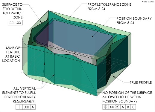

Here is Figure 8-24 from Y14.5-2009, with an additional position tolerance added:
The additional callout refines the relationship of the feature to Datum A.
Is this a valid application? ;^)

pmarc,
You are right, I didn't take into account the profile tolerance zone is not constrained in orientation. Thank you for pointing that out.
So eventually there is a refinement of 0.2 to orientation, resulting from the specified value of 1.
I don't like the indirectness of it.
I guess that's why I brought up "each line element" - more straightforward = less trouble in practice and more useful. Much like in the case of composite profile vs. profile + position boundary dilemma.

The point of my excellent diagrams, as you called them, was exactly to show that the 2 cases are not equally generous. If they were, we would not be able say that certain condition of the as-produced feature meets one scheme and does not meet the other.
pmarc,
I looked at your diagrams once again.
We calculated the same MMB (VC) and LMB (RC) boundaries that appear to be equivalent for both controls. Yes, I know the rotation phenomenon for the profile+position combo makes a difference and widens the LMB boundary in a peculiar way, but it didn't even make you update calculated 10.1 LMB width/height to a larger value, and for a good reason.
The 2 schemes not equally generous?
If you choose to call the phenomenon that caused the feature pass one control and be rejected by the other generous, so be it. In this particular case - I'd rather call it dangerous :-)
