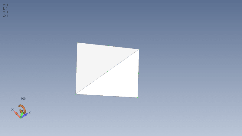

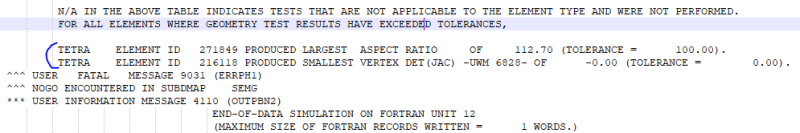

I was analyzing the centrifugal forces exerted from a propeller which I have assigned it to rotate along the z-axis at 100rps. Got a fatal error when I started running the analysis. Now, do I have to put constraints for this problem?

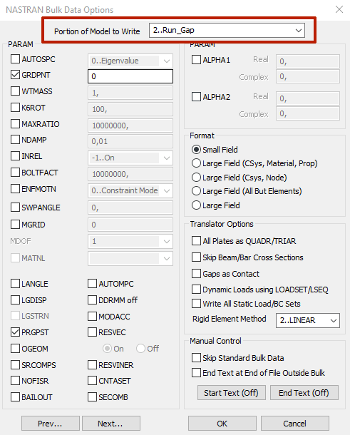

Attach .dat and .fo6 files. You create model in Femap Student Version and therefore this file cannot be opened in regular Femap package.

Pardon my mistake. Please find the .dat and .f06 below.
@rb1957 yes I am doing a static analysis of a propeller to determine the centrifugal force exerted by the prop while it is rotating at 100rps. The force that I applied to the model is a body force that is based on the weight of the model.

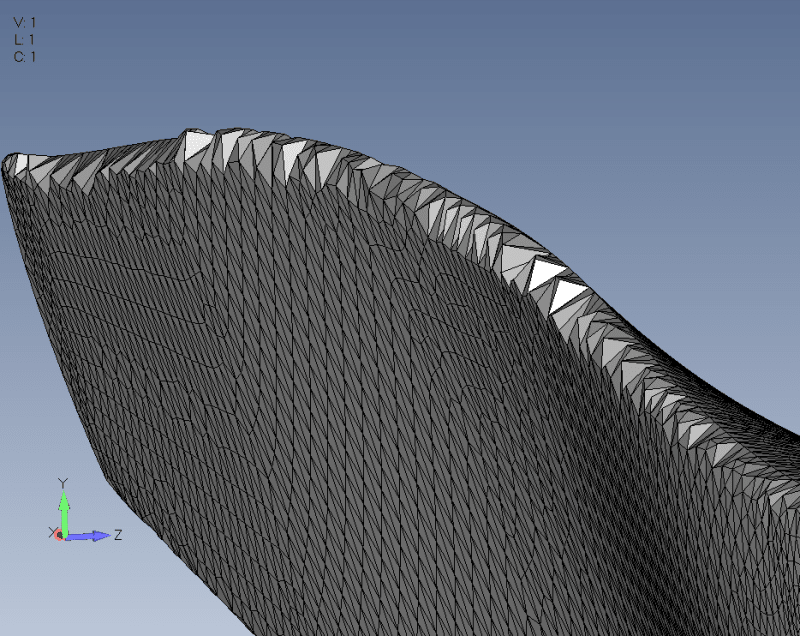

Mesh have large aspect ratios, try to check these elements first.
Some tetrahedral elements are collapsed. Solver cannot handle with too distorted elements.

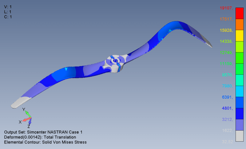

I`ve deleted some bad elements and managed to solve model.
@karachun, Thanks for your help. I am now able to see the deformed propeller.

- Delete elements mentioned in f06 (run Delete->Model->Elements or Delete->Model->Mesh and enter element ID from f06) and using Femap tool Tools->Check->Bad quality elements (select Aspect Ratio>=100 and Jacobian >=0,9, and set option "Make grout with distorted elements").
- Delete->Model->Nodes, select all nodes and press ok. Only nodes not connected to elements will be deleted.

Element deleting is urgent measure to show that problem in distorted elements, off course mesh is far away from good.

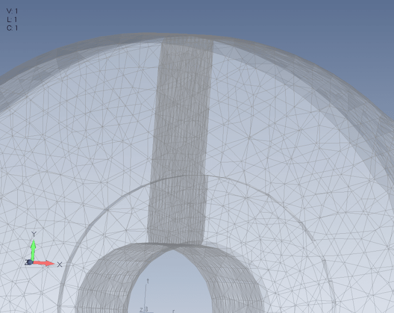

In addition - I check mesh and found that hub consist from two unconnected parts, some nodes may be merged but faces are differ.
@karachun..I know it is a bad mesh, then how do I improve with the mesh. Need your advise. As of the hub is concern I can use the combine tool to turn the two parts into 1 solid.

Here is one tip. Run Mesh->Model Preparation, then build triangular plate mesh. Manually delete bad surface elements and merge nodes, you may need to create some additional elements to close holes. Then you can run Mesh->Solids from elements and create 3D mesh from 2D. Sometimes much easier to edit 2D elements than to fight with bad geometry.

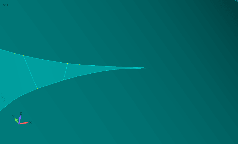

Try to avoid of surfaces with corner angles near zero. You can try to rebuild geometry in CAD program before sending to Femap.
Here is my variant of mesh - I run geom. preparation, create 2D mesh and create 3D mesh without 2D mesh repair. Model run without fatal errors.
